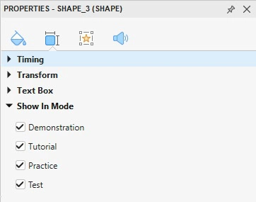

In ActivePresenter 10, the Show In Mode section is set reasonably in most cases. For example, cursor paths only appear in the Demonstration mode by default. If you want to customize these modes, you can change the default Show in Mode options of each object in the Properties pane. To do that, follow these steps:
Step 1: Select one or more objects.
Step 2: Navigate to the Properties pane > Size & Properties > Show in Mode. The four operation mode options will show below:
Then, select any check box to choose the corresponding mode for the selected object. Remember you can select multiple modes for a single object.
Note: You can choose operation modes for all objects on the same slide only. You can’t do this for all objects on multiple slides at a time.

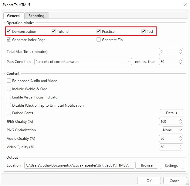

To choose operation modes to export a project, do the following:
Step 1: In the Export tab > HTML5. This opens the Export To HTML5 dialog.
Step 2: Look at the Operation Modes section in the General tab, and select any modes you wish. Then, customize options like Total Max Time and Pass Condition. Note that the Total Max Time option is only available for the Test mode.
- When exporting a project to video, the video output is automatically in the Demonstration mode.
- By default, all four operation modes are selected. But you can select only the modes you want.
