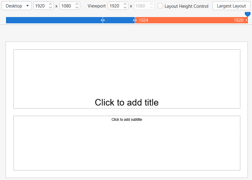

By default, ActivePresenter defines three responsive layouts which correspond to the most popular device screen sizes:
Desktop with a viewport of 1920 x 1080
Tablet with a viewport of 1024 x 1366
Mobile with a viewport of 768 x 1280

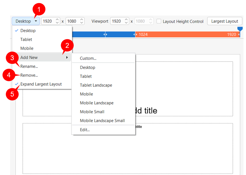

On the Responsive Bar, the currently selected layout is orange. To switch between layouts, click one of those layouts on the bar.  Alternatively, click the drop-down arrow (1) and select one of the available layouts in the list.

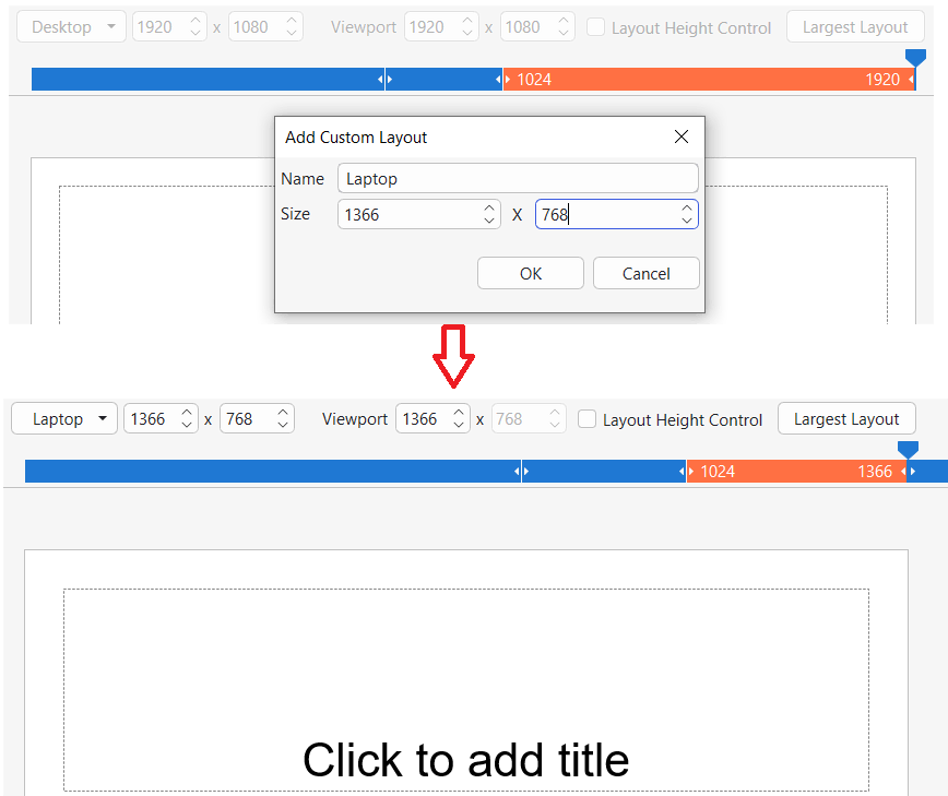

Furthermore, you can add a new layout. Click (2) > Custom… In the Add Custom Layout dialog, type a name and adjust the size of the layout. Then, click OK to finish.
add layout new
The app also allows you to rename (3) or remove any layout (4).
Change Viewport Width

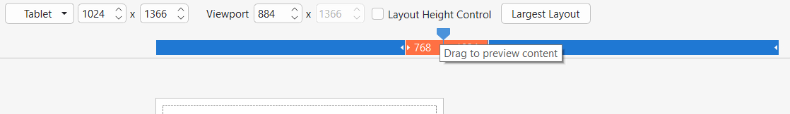

Drag the handle on the Responsive Bar left or right to change the viewport width. It is previewed in the Viewport.
layout width
In most cases, the width of the new layout must be within the range of the currently selected layout’s width. For example, if you are selecting the Tablet device layout, you can only drag the slider within the width range (768, 1024].
Additionally, by default, the Expand Largest Layout option (5) lets the slide be the full width of the device.

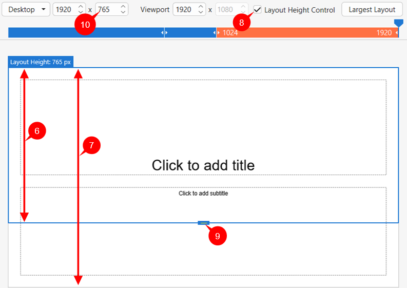

The layout height (6) is used as the standard size for slide height (7) when previewing on Canvas. For example, by default (in the 100% Device Height mode), the layout height will act as the device height. It helps you to preview the content without running on the actual device.
Slide Height
Follow these steps to show and change the layout height:
  • To show the layout height: Tick the Layout Height Control checkbox (8) on the Responsive bar. Then, a blue-bordered rectangle appears. It matches the slide’s border.
  • To change the layout height: Drag the layout height control (9) up or down. Another way is to change the value in the Layout Height spin box (10). Do that by clicking the up/down arrow or entering a new value in the combo box.

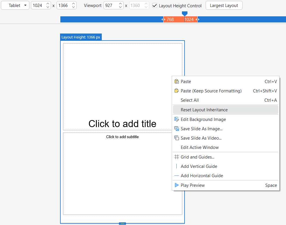

Inherit Properties of Layouts
In a responsive project, a layout inherits properties from a larger layout. This is called layout inheritance.
For example, you inserted an object in the Desktop as the largest layout. When you switch to other smaller layouts on the left, the object retains its properties. If you change the object’s position in the Tablet layout, that property will be inherited in all smaller layouts while it keeps unchanged in the larger layout (Desktop).
Note: If you already changed the properties of that object in a smaller layout, it won’t inherit those from its larger layout.
From then on, if you wish to change any properties, you should do so first on the largest layout.
And, after making changes to these properties of a smaller layout, if you don’t need it anymore,  simply reset it. Just right-click the object > Reset Layout Inheritance.

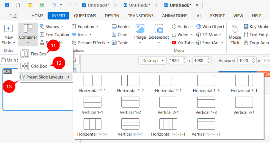

To add flex or grid containers, open the Insert tab > Container > Flex Box (11) or Grid Box (12). To save time when designing slides, select Preset Slide Layout (13). The app made preset slide layouts with the default flex container layout.
After that, you can change the Flex Child, Container Layout (if any), and Text Box’s properties in the Size & Properties tab of the Properties pane.

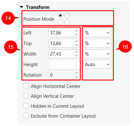

Change Object Position Mode
Position mode allows pinning objects to the corner of the slide. As a result, they can be set to relative the top left, top right, bottom right, and bottom left corner of the slide. It affects how the objects adapt to the viewport size changes.
To access the object position mode, select the object > Properties pane > Size & Properties tab > Transform section > Position Mode (14). Then, select one of the 4 radio buttons corresponding to the 4 modes.
Transform section
Change Object Position and Size
After choosing a position mode, now you are able to change the relative distance from an object to the pinned corner of the slide.
For example, in the picture above, you are choosing the position mode as Top Left (the currently selected radio button). Therefore, in (15), the Left and Top spin boxes are shown. You can see their values are 37.86% and 13.66%, respectively. It means, the position of the object to the left edge and top edge equal 37.86% and 13.66% of the width and height of the viewport. It will always keep its relative distance to these edges regardless of the viewport sizes.
Now, to change the object position, enter the new values to the spin boxes as you wish.
Additionally, it’s easy to resize the object. To do that, just change the value in the Width and Height spin boxes in (15). However, there are 2 types of units: % and pixel. To know how different the objects look in each unit, let’s go to the next part.
Change Object Position and Size Value Unit
You can change the unit of object position and size value between percentages (%) and pixels (px) in (16).
  • Choose % if you want the object size and position to be a percentage of left/top/width/height. Using a percentage unit keeps the position and size of objects relative to the viewports.
  • Choose px if you want the object size and position to be a number of pixels of left/top/width/height. The size and position of the object keep unchanged when you change the viewport of the current layout.
  • Choose Auto in one of the Width or Height spin boxes to retain the aspect ratio. For example, if you choose Auto in the Height spin box, the object height will automatically change according to the width.

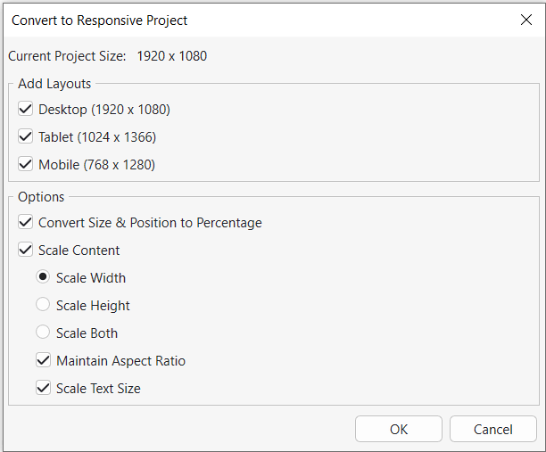

To do that, click the File button > Project > Convert to Responsive Project…
Next, select the layout you want to preserve in the Add Layouts section. You can also choose to convert size & position to percentage as well as scale content in the Options section. When all the settings satisfy you, click OK. The current project will turn into a responsive project with the layouts you have selected.
