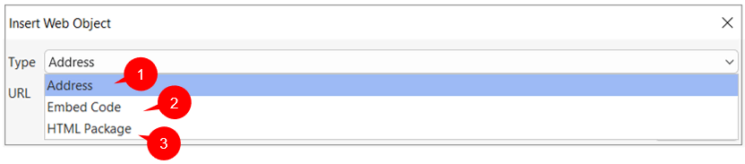

To insert any web object type in ActivePresenter 10, open the Insert tab first. Then, select Web Object . The Insert Web Object dialog appears, which allows you to select and add one of three types.
Select a web object type from the Type combo box
Add Web Address

Step 1: Click the Type dropdown list > select Address (1).
Step 2: Type a website address into the URL field (4). Alternatively, you can copy your desired website URL and paste it here.

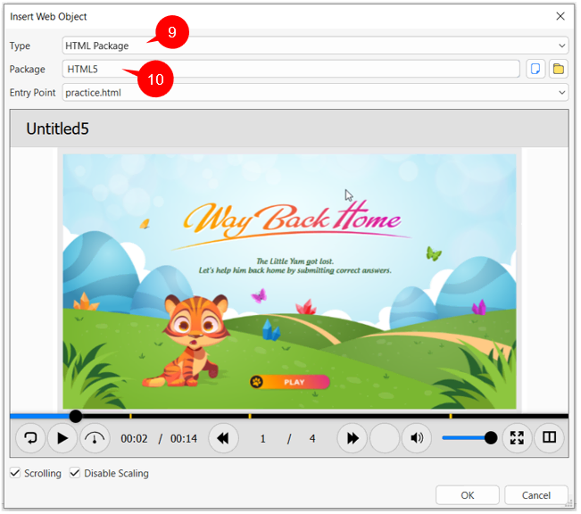

Embed HTML Package
Finally, let’s try out embedding HTML packages. This web object can help enhance your interactivity with HTML resources such as games, courses, and reference materials.
In general, inserting an HTML Package is similar to adding an address or embedding lines of code. However, make sure you have an HTML5 file initially. Then, take the following steps:
Step 1: Click the Type Combo box > HTML Package (3).
  • Click to select a package from your current project.
  • Click to choose a folder from your computer.
After that, the package’s name will be shown in the Package box (9).
embed HTML Package
Step 3: Select one entry point from the drop-down list (10). The selected HTML package will load and preview right in the dialog.
Then, perform steps 4 and 5 as guides in the first part.

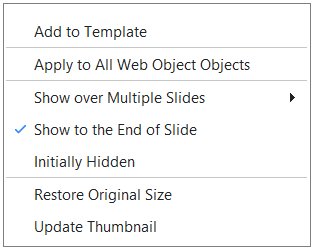

If you want to save and reuse a web object, right-click it > Add to Template to hold it in the Object Templates. See Create and Use Object Template for details.
To apply the same type of the selected web object’s animation and show in mode to all other existing ones, right-click it > Apply to All Web Object Objects > Animation/Show In Mode.
To resize the inserted web object on the Canvas, quickly drag its resizing handles. In case you aren’t satisfied with the changes and want to go back to the original size, right-click it > Restore Original Size.
In addition, you can also update the thumbnail to the latest thumbnail by right-clicking the web object > Update Thumbnail.
