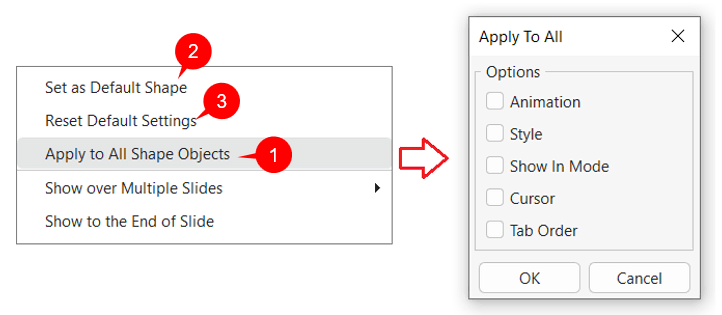

Step 2: Apply the animation and style of the object to all other existing objects of the same type. To do that, right-click the object > Apply to All Objects (1). Then, you can choose to apply for the Animation, Style, or Show In Mode of the selected object.

  • Right-click your customized object on the Canvas > Set as Default (2).

By doing any of the above, the new style will be applied to all the new objects of the same type in the same project. If you want to reset the default setting, you can right-click on the customized object or any newly inserted objects on the Canvas, then select Reset Default Settings (3). The change will be applied to the next added objects of the same type.
