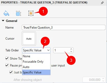

Set up Tab Order for Objects
As said earlier, you can use the Tab Order to navigate between objects using the TAB key instead of clicking an object. This feature can be used for many objects such as text captions, buttons, check boxes, questions, and more. To view this feature, do as follows:
  1. Select the object.
  2. Open the Interactivity tab (1) of the Properties pane.
  3. In the General section, access Tab Order (2) and select one option from the list.
tab order in properties pane
Focusable OnlyIf an object is set to be focusable, it will gain focus automatically if no object in the content has the focus at the time it is displaying.
AutoActivePresenter will order objects automatically. When users press the TAB key, objects will be focused randomly.
Specific ValueDefine a specific order for an object. Selecting this option, you have to specify the value in the Tab Order spin box (3). When users press the TAB key, objects will gain the tab focus in the order you’ve set.
NoneSelect this if you don’t want to give objects any tab order.

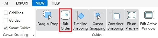

Show or Hide Tab Order Value on Canvas
Once you set the Specific Value for objects, you can show these values on Canvas in the editor, not in the output. To get it done, you open the View tab and select Tab Order.
show Tab Order value on canvas
Hence, the values will be shown on the Canvas like this:

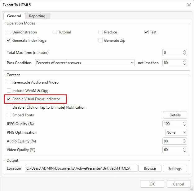

Enable the Visual Tab Focus Indicator
When the object gains tab focus in order, the dotted line will outline the object so that users can easily see it. To show the dotted line, you do the steps as follows:
Step 1: Access the Export tab, click HTML5 . This opens the Export To HTML5 dialog.
Step 2: In the General tab of the dialog, select the Enable Visual Focus Indicator check box. Then click OK.
enable visual indicator in html5
In the HTML5 output, the dotted line appears to indicate the tab-focused object when users press the TAB key.
