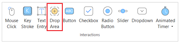

Insert Drop Areas
To insert a drop area object, do either of the following ways:
  • Open the Insert tab > Drop Area.
Insert Drop Areas
  • Open the Home tab > Interactions > Drop Area.

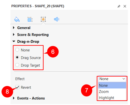

Convert Objects into Drag Sources
ActivePresenter 10 allows you to add more drag sources as you want by converting objects such as shapes, images, etc. Perform the steps below to have it done:
Step 1: Select one or multiple objects > navigate to the Properties pane > Interactivity tab > Drag-n-Drop > select Drag Source (6):
Step 2: Select one effect from the Effect list (7):
  • None: No effect happens when users drag a drag source.
  • Zoom: The drag source will be zoomed in when users drag it.
  • Highlight: The drag source will be highlighted when users drag it.
Step 3: Select or deselect the Revert checkbox (8). When this option is selected, a drag source will return to its original position if you drop it outside the drop area.
  • You can convert multiple objects into drag sources at once.
  • If you have multiple drag sources, you should rename them for easy identification when setting accepted and correct values. To do that, select a drag source > Properties pane > Interactivity tab > General > enter a new name.

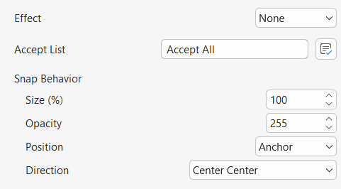

Set Drop Area Object Properties
To set up properties for a drop area, select it > Properties pane > Interactivity tab > Drag-n-Drop.
  • Effect: Choose one effect from the Effect list as you do with drag sources.
  • Snap Behaviour: Edit properties of drag sources after users drop them into a drop area.
    • Size: Change the value to resize drag sources.
    • Opacity: Set the opacity level from 0 to 255 for drag sources.
    • Position: Define the location of drag sources with three options: Absolute (keep drag sources at the same position as where users drop them), Anchor (snap a drag source to an anchor point of a drop area), Tile (arrange a drag source so that it lies on a drop area without covering each other).
    • Direction: Select a direction option if you select Anchor or Tile position.

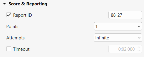

Set Score and Reporting
A drop area object can not only validate learners’ actions but also give them points for correct actions. To set points for correct actions, select the drop area > Properties pane > Interactivity tab > Score & Reporting.
  • Report ID: Track users’ activities. You can rename it to a meaningful name.
  • Points: Set points for correct actions.
  • Attempts: Set how many times users can drop a drag source onto the drop area.
  • Timeout: Set a time limit for users to complete drag-n-drop action.

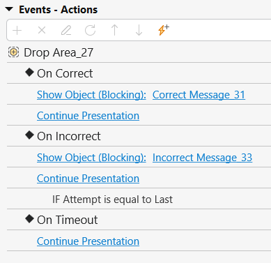

Add Events – Actions
Like other interaction objects, the drop area object also has default events – actions:
However, you can add more, edit or remove them if you want.

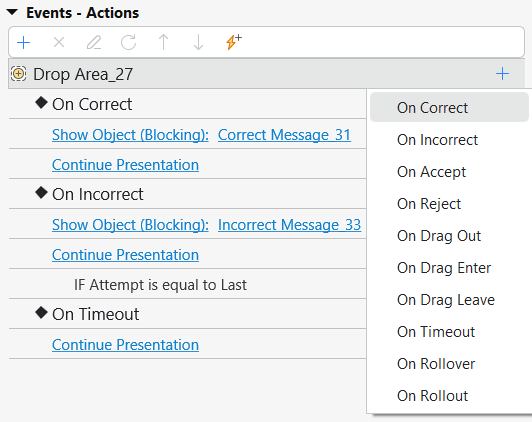

  • On Correct: Occur when users drag any correct drag source into a drop area.
  • On Incorrect: Occur when users drag any wrong drag source into a drop area.
  • On Accept: Occur when users drag any accepted drag source into a drop area.
  • On Reject: Occur when users drag any rejected drag source into a drop area.
  • On Drag Out: Occur when user move a drag source out of a drop target/drop area.
  • On Drag Enter: Occur when a drag source enters a drop area.
  • On Drag Leave: Occur when a drag source leaves a drop area.
  • On Timeout: Occur when users don’t respond within the specified time.
  • On Rollover: Occur when the mouse rolls over the drop area.
  • On Rollout: Occur when the mouse rolls out of the drop area.
