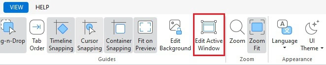

Sometimes, you may need to edit the active window. To do that, open the View tab > Edit Active Window.

Alternatively, right-click anywhere on the Canvas and select Edit Active Window.

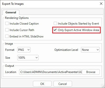

As mentioned above, ActivePresenter 10 allows you to export the active window only when you export projects to images, or document formats. In the export dialog, remember to select the Only Export Active Window Area checkbox.
