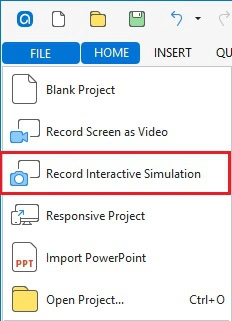

  • In Start Page > click Record Interactive Simulation.
  • In the workspace > click the File button on the top left corner > Record Interactive Simulation.

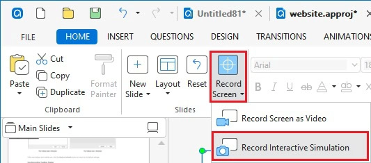

Additionally, ActivePresenter 10 lets you easily add interactive simulations to existing projects. To do that, do either of the followings:
  • Open the Home or Insert tab > New Slide > Record Interactive Simulation.
  • In the Home tab > Record Screen > Record Interactive Simulation.

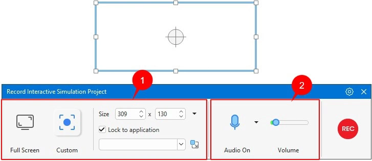

After selecting to record, a blue-bordered rectangle and the Record Interactive Simulation Project dialog appear. They allow you to define the Recording Area (1) and turn on/off the Audio (2) before recording.
Drag the blue rectangle to anywhere on the screen to specify the recording area manually. This action can also be done by using tools and commands in the Recording Area section of the dialog.
1. The Recording Area Section
In this section, you can:
  • Click Full Screen to record the whole screen.
  • Select Custom to record a specific area on the screen.
  • Click the drop-down arrow next to the Size spin boxes to choose a preset size. It offers you many options of sizes from small to full HD. If it doesn’t satisfy you, select Customize… to add and edit the sizes you wish.
Customize the size of recording area.

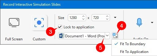

  • Tick the Lock to application checkbox (3) if you want only to record a current operating application. It offers you 2 options (4): Fit to Boundary and Fit to Application. The first one lets the application auto-fit the size of the blue-bordered rectangle. The second one can automatically adjust that rectangle to match the border of the app. Then, simply select one of the apps shown in the list (5).

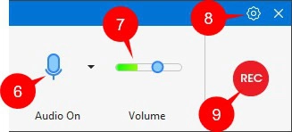

If you want to record audio, click the microphone icon to turn it on. Once the icon turns blue (6) means it is enabled.
Afterwards, you can click the arrow next to it to choose an audio input. It allows you to record audio from a microphone or the system simultaneously or separately.
Record Interactive Simulation > Select audio input
You can also drag the thumb of the Volume slider (7) to the left or right to decrease or increase the volume.
Otherwise, just click again to turn the Audio button off if you don’t want to record audio.

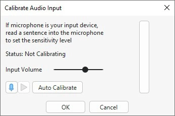

3.4. Calibrate Audio Input
In the last step, you can adjust the audio input before recording. As noted above, you’d better record narration after finishing the progress. In any case, the feature will help you get appropriate audio input for your project if you want it.

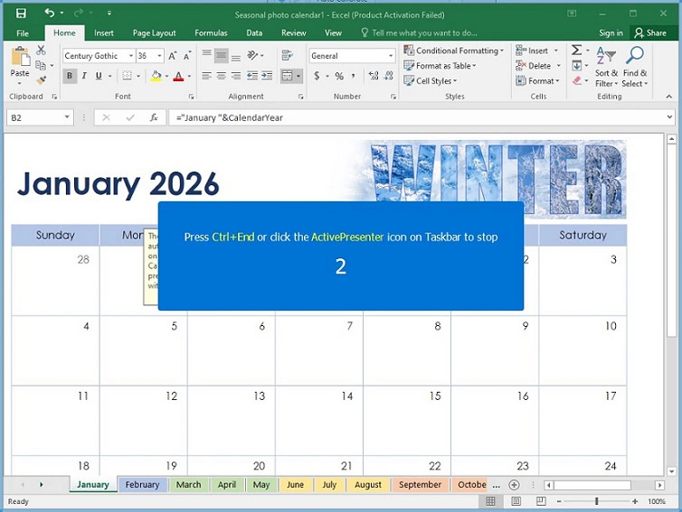

After being done with those settings, you can click the REC button (9) to start recording. ActivePresenter 10  will record the area that you have set up. Then, a pop-up appears and shows that the progress officially starts after 3 seconds.
It also lets you know how to stop recording by pressing Ctrl+End (for Windows) or clicking the ActivePresenter icon on the Taskbar. For macOS, press ⌥⌘2. Alternatively, click the Stop button in the Recording Toolbar dialog.

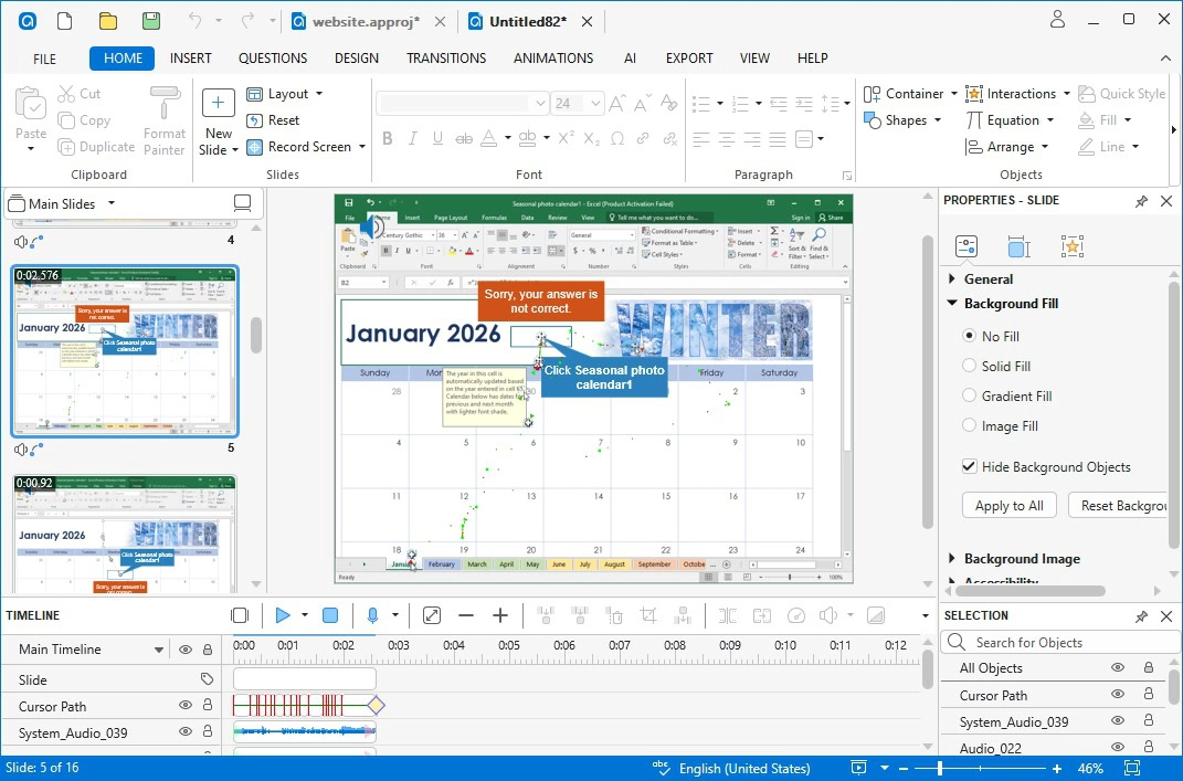

Then, you will then see a series of slides containing the steps you have taken in the Slides pane.
A slide-based project will result from all actions on the screen. Slide names can be automatically created by ActivePresenter, as well as smart annotations, cursor paths, mouse clicks, keystrokes, and feedback messages. As a result, you can save yourself a lot of time and effort during the editing process.
