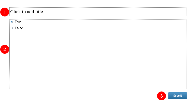

Then, a new question slide including 3 sections is inserted into your project like below:
true false quiz in ActivePresenter
(1): The top text box to add the question title
(2): The answer area with two default answer options: True – False
(3): The Submit button.

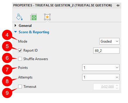

  • To set the score and reporting for a True/False question, select the answer area of the question. Then, go to the Properties pane > Interactivity tab > Score & Reporting.
set score and report
This section provides a lot of options to:
(4) measure learners’ performance (select the Graded mode) or collect learners’ feedback or information (select the Survey mode);
(5) track learners’ results;
(6) mix up answer options when the question is presented to learners;
(7) set points for correct answers;
(8) set the maximum number of attempts that learners can interact with the question;
(9) set a time limit that only allows learners to respond to the question in the given period.

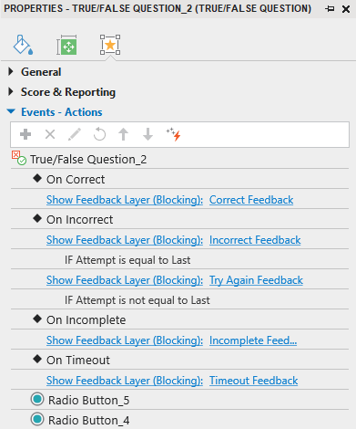

6. Set Events – Actions
ActivePresenter offers default events and actions for True/False questions. Generally, a True or False quiz has four default events for the Graded mode (On Correct, On Incorrect, On Incomplete, and On Timeout) and three for the Survey mode (On Complete, On Incomplete, and On Timeout).
If you select the Graded mode, here is what you see in the Properties pane:
events actions
You can remove, change, or make events and actions for True/False questions more advanced as you desire. To do that, first, select the answer area. Then, access the Properties pane > Interactivity tab > Events – Actions
