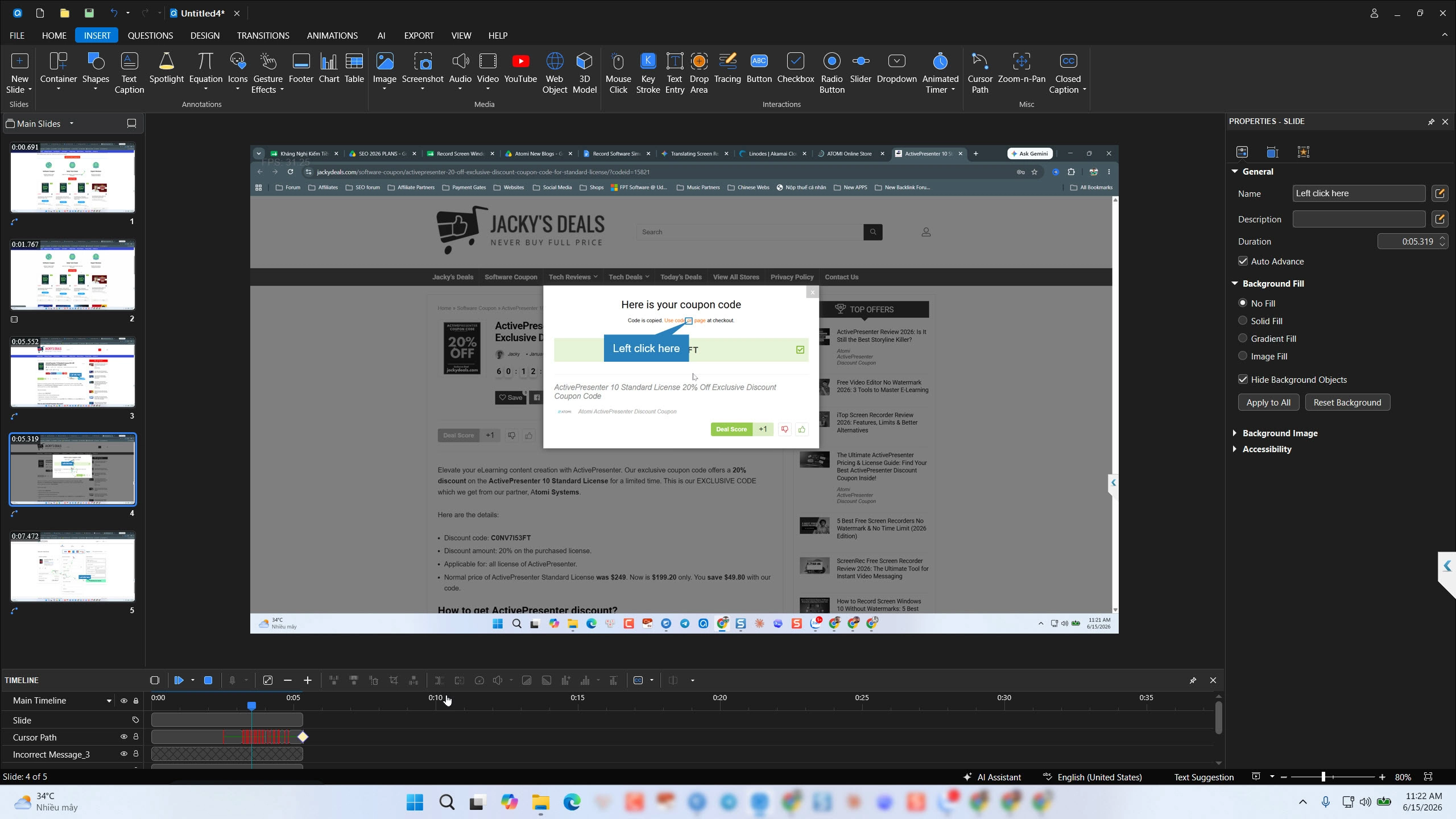

Step 3: Record the Simulation — Let ActivePresenter Do the Work
Click the red Record button in the dialog. The toolbar hides itself, and you’ll see only the thin blue border around your target application. Now, simply perform the workflow you want to teach.
Here’s what happens automatically behind the scenes with every action you take:
  • Every mouse click → Generates a new slide with a Mouse Click interaction placed at the exact click coordinates
  • Every keystroke / text entry → Captured and converted into a Text Entry interaction
  • Every drag action → Recorded as a Drag-and-Drop interaction
To stop recording: Press Ctrl + End (Windows) or the equivalent hotkey you configured.
Pro Tip #2: Before you start recording, do a full “dry run” of the workflow without recording. Muscle memory makes your recorded actions cleaner, your mouse movements more deliberate, and your final slides less cluttered with accidental clicks.
Step 4: Review and Refine Your Simulation Slides
After stopping, ActivePresenter drops you directly into the slide editor with your full simulation ready. This is where your expertise as an eLearning developer comes into play.
ActivePresenter's video editor
What to Review First
  • Delete unwanted slides — accidental clicks, navigation errors, or redundant steps
  • Adjust Mouse Click zones — resize or reposition the clickable hotspot for accuracy
  • Edit Smart Annotations — the auto-generated text is functional but generic; rewrite it to match your brand voice and learner context
  • Customize feedback messages — default “Correct/Incorrect” messages work, but tailored feedback (“Great! You selected the correct account type — this prevents processing errors downstream”) dramatically improves learning retention
