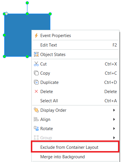

If you do not want the objects to automatically snap when moving them, perform one of the following:
  • Hold down ALT while moving the objects.
  • Right-click the objects > select Exclude from the Container Layout.
right-click object and select Exclude from Container Layout

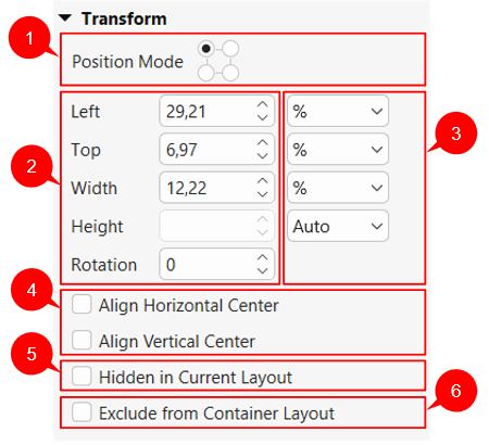

  • Select objects > access the Properties pane > Size & Properties tab > Transform section > select the Exclude from the Container Layout checkbox (6) (see the image below).

To change the position unit, you need to select the object, then navigate to the Properties pane > Size & Properties > Transform. After that, you can change the object position, position mode, and object position value, and align the object as you wish.
Change position and unit of objects
Keep reading to know each of them for details.
Change Object Position Mode (1)
Position Mode is the exact specification of the object position in a slide of a project.
To change this value of an object, go to the Size & Properties tab > Transform > Position Mode (1) > select one from four modes (Top-Left, Top-Right, Bottom-Right, or Bottom-Left).
Change Object Position and Size (2)
Depending on the Position Mode type you select, the values (Left, Top, Right, and Bottom) define the object position in a slide. For example, if you select the Bottom-Right mode, this section will show the Bottom and Right values instead of showing the Top and Left values as in the Top-Left mode.  
To change those values, select the object, then, adjust values of Left, Top, Right, Bottom, Width, and Height (2) (in percentages or pixels).
Note: If you want to keep the height-to-width/ width-to-height ratio when changing the object width/height, select Auto in the Unit box next to the Height/Width spin box. This option automatically changes the height according to the width and vice versa.
To rotate the object, along with dragging the rotation handle of the object, you can enter a value in the Rotation spin box.   
Change Object Position Value Unit (3)
You can change the unit of object position value between percentages (%) and pixels (px) in the Unit drop-down lists (3) next to the Size spin boxes. Then, select %, px, or Auto (for Width and Height unit).
  • Choose the % unit if you want the object position to be a percentage of left/top/width/height.
  • Select the px unit if you want the object position to be a number of pixels of left/top/width/height.
  • Choose Auto in the Width/Height unit box to retain the aspect ratio.
Note: Either the unit you choose, the size and position of the object should remain unchanged.
Aligning Objects (4)
You can align objects at the center of the slide in all layouts of responsive projects. select Align Horizontal Center or Align Vertical Center (4).
  • Align Horizontal Center: The object will be aligned horizontal center and you can move the object only in the vertical direction of the slide. You cannot move it horizontally.
  • Align Vertical Center: The object will be aligned vertically center and you can move the object only in the horizontal direction of the slide. You cannot move it vertically.
Note: If you select both check boxes, objects will be aligned both horizontally and vertically in the center of the slide. This means that you cannot move the object either in the horizontal or vertical direction.
Showing/Hiding Objects in Individual Responsive Layout (5)
ActivePresenter 10 allows showing or hiding the object in each layout individually. To do that, in the layout where you want to hide the object, select Hidden in Current Layout (5).

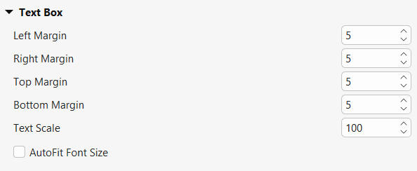

Text Box
This section allows you to customize the position of the text inside its container in four directions (Left, Right, Top, and Bottom) and scale text in other layouts.
