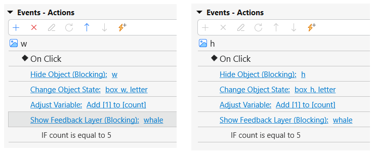

To get the result as in the demo above, you can add the On Click event and the same set of the following actions to letter images W,H,A,L,E.
same set of actions in multiple objects
In which, “count” is a customized number variable. When you click on the letter, it will add 1 point to that variable. Once the variable value reaches 5, a feedback message will be shown.

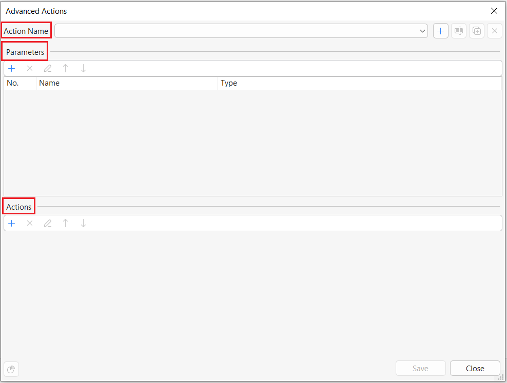

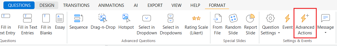

Firstly, to add an Advanced Action, you access the Questions tab and select Advanced Actions to open the Advanced Actions dialog.
open the advanced actions dialog
Alternatively, you can navigate to the Properties pane > Interactivity tab > Events-Actions section > click on the Advanced Actions icon.
After that, you can see the following dialog appears with three sections: Action Name, Parameters, and Actions.

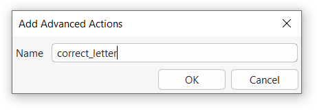

In the Action Name section, click on the green plus button to add a new advanced action. Give it a specific and meaningful name, eg. correct_letters, then click OK.
Name an advanced action
Note that you can use the commands in this section to rename, duplicate, or delete any advanced action if you want.

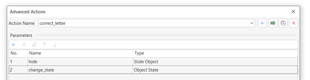

Take the demo at the beginning as an example:
You need to hide and change the state of several letter images. So you create 2 parameters and choose the corresponding type.
add parameters
Note: Each added parameter in an advanced action must be in proportion to the created action depending on your purposes.
After adding a parameter, you can edit it (rename, change parameter type), change its positions (move up, move down), or remove it.

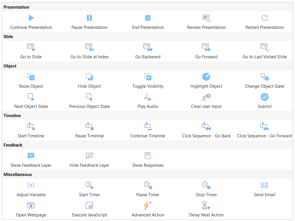

After finishing adding parameters to the Advanced Action, you click on the green plus button under the Actions section to add actions, and choose one action from the list that pops up:
actions in advanced actions

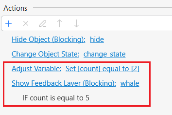

Then, click on Click to edit line to take further steps with your action. If you need to apply the action to multiple objects, you select the Param checkbox and choose the parameter applicable to that action.
add actions and select parameter
Then, you can edit other properties of action as normal.
Note: You can still add actions not using parameters in the Advanced Actions dialog. The target object/value in this action is specified.
actions not using parameters in advanced actions dialog

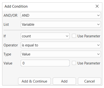

To add a condition to an action, you click on the green plus button next to the action name. The Add Condition dialog will appear as follows:
add condition to action in advanced actions dialog
This dialog is similar to the one you have when adding conditions to a normal action. However, it has the option to use parameters. Select this option and choose a corresponding parameter.

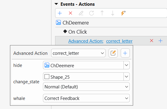

Step 1: Select the object, eg, a letter image, in the Properties pane > Interactivity > Events – Actions > click on the green plus button next to the object name > select an event.
Step 2: Click on the green plus button next to the event entry or Click to add action line > select Advanced Action.
(For more detailed information about how to add Events – Actions, refer to this tutorial).
Step 3: Click on Click to edit line and choose the name of Advanced Action.
After doing that, parameters that have already been created will appear, then click the drop-down arrow to select the suitable values.
apply advanced action to event
