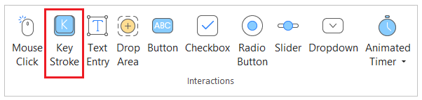

Insert Key Strokes
  • Open the Insert tab > Key Stroke.
Insert Key Stroke Objects
  • Open the Home tab > Interactions > Key Stroke.

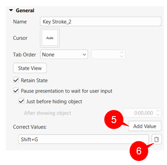

Set Correct Values for Key Strokes
As mentioned above, a key stroke object has two default feedback messages: Correct (2) and Incorrect (3). So, to make the system understand which are correct actions and which are not, you need to set the correct values.
Follow the steps below to have it done:
Step 1: Select the target area > Properties pane > Interactivity tab > General > Correct Values > Add Value (4). Then, a blank box appears.
Set Correct Values for Key Stroke Objects
Step 2: Click the blank box and press a key or combination of keys.
If you want to add more correct values, click the Add Value button and repeat step 2. By contrast, click the Remove button (5) to delete unwanted values.
Note that don’t use keys/key combinations that are common in browsers such as CTRL+C or ALT+D.

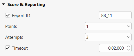

Set Score and Reporting
Like mouse clicks, key stroke objects also help validate users’ actions and give users points for correct actions. To set points for correct actions, select the target area > navigate to the Properties pane > Interactivity tab > Score & Reporting.
score and reporting
This section provides you with some properties to customize:
  • Report ID: Track users’ activities. You can rename it to a meaningful name.
  • Points: Set points for correct actions.
  • Attempts: Set the maximum attempts that users can press a key/combination of keys.
  • Timeout: Set a time limit that only allows users to press a key/combination of keys in the given time.

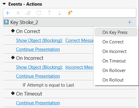

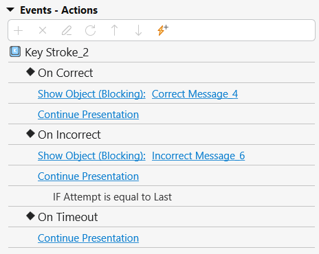

Add Events – Actions
When you add a key stroke object to a slide, ActivePresenter 10 automatically adds default events – actions to it as in the below image:
Add Events – Actions to key stroke objects
  • On Correct: Occur when users press shortcut keys correctly.
  • On Incorrect: Occur when users press shortcut keys incorrectly.
  • On Timeout: Occur when users don’t respond within the specified time.
Besides, there are three additional events you can add to the key stroke including On Key Press, On Rollover, and On Rollout:
  • On Key Press: Occur when users complete pressing shortcut keys.
  • On Rollover: Occur when the mouse rolls over the target area.
  • On Rollout: Occur when the mouse rolls out of the target area.
After that, continue adding actions to events, and conditions to actions if necessary.
