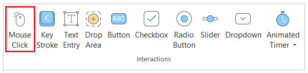

Follow either of the following ways to insert a mouse click object:
  • Open the Insert tab > Mouse Click.
  • Open the Home tab > Interactions > Mouse Click.

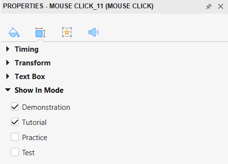

In the output, the target is set to be visible in the Demonstration and Tutorial modes and hidden in the Practice and Test modes. You can find this setting in the Properties pane > Size & Properties > Show In Mode:

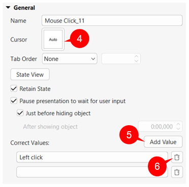

Step 1: Select the target area > Properties pane > Interactivity tab > General > Correct Values > Add Value. Then, a blank box will appear.
Step 2: Place the cursor over the blank box and left-click it.
Set correct values for mouse click objects
The correct values can be with or without modifier keys (SHIFT, CTRL, or ALT). For example, you want to set the combination of the CTRL key and left click as the correct value. Just hold the CTRL key and left-click the blank box.
In case you want to add more correct values, click the Add Value button (5) and repeat step 2. On the other hand, if you want to remove any correct value, click the (6) button.

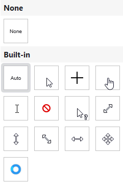

Besides, you can change the image of the mouse cursor to make the clickable area identifiable when users hover the mouse over it. To do that, click the (4) button and select the hand cursor image.
Change the image of the mouse cursor
