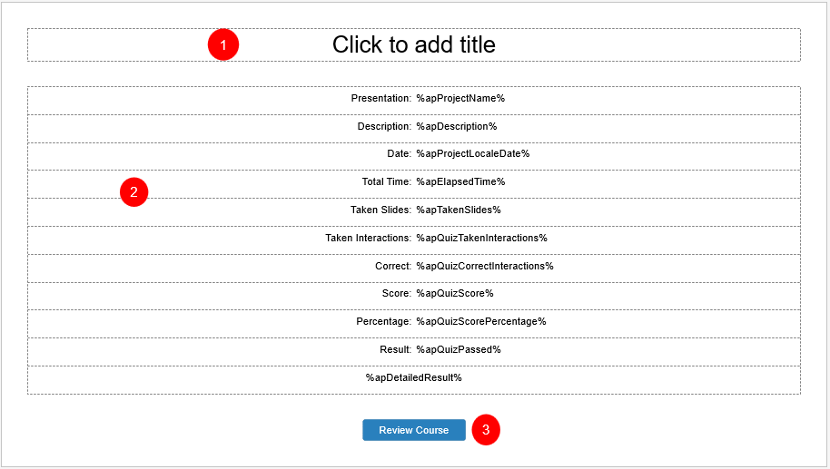

Then, you will see a Report Slide inserted into your project like this:
Interface of report slide in ActivePresenter 10
A Report Slide contains three parts, namely the top text box to add the slide title (1), the default parameters (2), and the Review Course button (3).

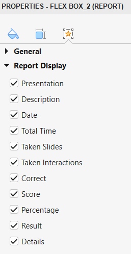

Show/Hide Default Parameters
There are 11 default parameters on a Report Slide. You can show or hide them by performing the following steps:
  1. Select the default parameters section (2).
  2. Navigate to the Properties pane > Interactivity tab > Report Display section.
  3. Tick/Untick the parameter boxes that you wish to show/hide on the Report Slide.
Show or hide report slide parameters
PresentationName of the project
DescriptionDescription of the project
DateThe current date in the format of the project language
Total TimeThe elapsed time in the format hh:mm:ss since the presentation started playing
Taken SlidesThe number of taken slides in the project
Taken InteractionsThe number of taken interactions in the project
CorrectThe number of correct interactions in the project
ScoreThe total score
PercentageThe total score as a percentage
ResultThe result of the quiz (passed or failed)
DetailsThe detailed report

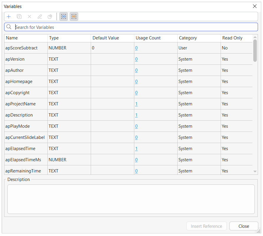

In the Report Slide, Aside from the 11 default parameters above, you can also add customized ones by using text-based objects and variable references.
To insert a reference into a text-based object, do the following:
  1. Click the text area of the text-based object to open the inline text editor.
  2. Click the Home tab > Reference.
  3. In the System tab of the Variables dialog, select a variable that you would like to add.
System variables in ActivePresenter
For more information about system variables in ActivePresenter, please see the User Manual (pages 285– 290).

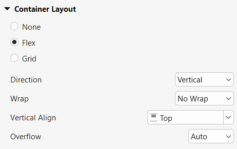

Change the Container Layout
The Container Layout of the Parameters section in the Report Slide is Flex by default. However, you can switch to another layout if you want.
To change the container layout, access the Properties pane > Size & Properties tab > Container Layout section. In this section, ActivePresenter 10 offers you three options: None, Flex, or Grid. Select the layout mode that you want. Then, you can customize its properties.
Container layout
See Question Container Layouts for more details.
