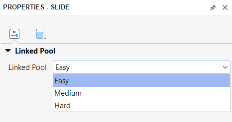

Step 1:  In the Slides pane, select one or more random slides.
Step 2: In the Properties pane > Slide Properties > Linked Pool > select a pool from the Linked Pool drop-down list.
Link random slides to slide pools
Note: You must create slide pools first. Then, these pools appear in the Linked Pool drop-down list.
