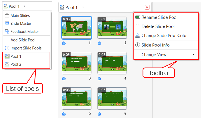

Step 3: Modify the pool:
Modify the pool
(3) Rename a question bank.
(4) Delete a question bank if you no longer use it.
(5) Change the color to a question bank. This color will be shown in the random slides added later to create a randomized quiz
(6) Change question bank view: Change the question bank view in one of three modes: Slides in Column, slides in grid, and Slides in Titles

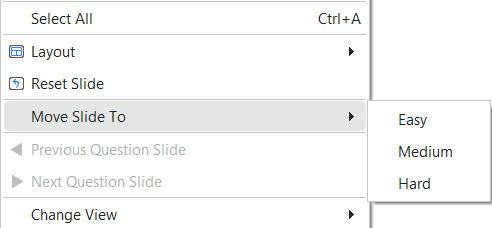

Add Slides in Slides pane to a Slide Pool
To add slides to a pool, in the Slides pane, right-click one or more slides > Move Slide To > select a pool. As these slides are moved to the Slide Pools pane, they no longer appear in the Slides pane.
move slides to slide pool

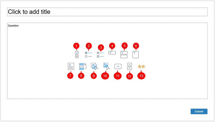

You can also create question slides right inside the pool. ActivePresenter currently supports you to create 13 types of interactive questions with a few clicks.
(1) True/False
(2) Multiple Choice
(3) Multiple Response
(4) Fill in Text Entry
(5) Fill in Text Entries
(6) Fill in Blanks
(7) Essay
(8) Sequence
(9) Drag-n-Drop
(10) Hotspot
(11) Select in Dropdown
(12) Select in Dropdowns
(13) Rating Scale (Likert)
After having questions in a bank, you can freely edit them as normal. For example, cut/copy/delete slides, change slides’ layout, add objects to them, etc.

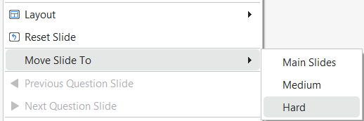

Move Slides from a Pool to Another
The app allows you to move any slide in a pool to another pool or the current project as well. To do this, perform these steps:
Step 1: Select a pool from the Pool drop-down list.
Step 2: Right-click one or more slides in that pool > Move Slide To > select another pool or the Slides pane in the current project to which you want to move that slide.
move slides from pool to another place
Note: Apart from this, you can also copy slides in a pool and paste them into another pool or into the Slides pane.

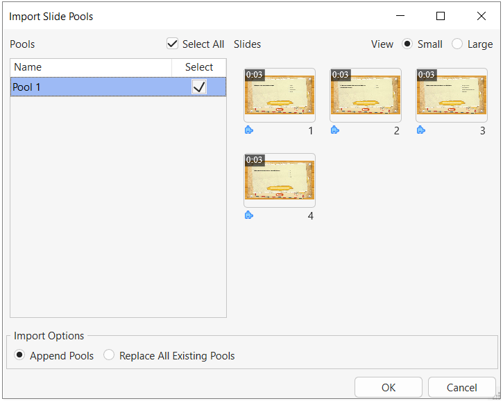

Import Slide Pools from Other Projects
You can reuse slide pools across projects. Do as follow:
Step 1: In the Slide Pools pane > Import Pool.
Step 2: Browse your file system and select a project file (*.approj) that contains slide pools you want to reuse. Then, the Import Slide Pools window appears like this.
import slide pools
This window has two boxes:
  • The Pools box is where to show pools in the selected project.
  • The Slides box displays all slides in each pool. To change the view mode, click the Small or Large button.
Step 3: Select a pool to import. By default, all pools are selected. But if you don’t want to import any pool, just deselect the corresponding check box.
Step 4: Select import options.
  • Append Pools: Import a pool as a new pool and keep all previously created pools in the current project.
  • Replace All Existing Pools: Import a pool as a new pool and replace all previously created pools in the current project.
Step 5: Click OK to apply changes.
