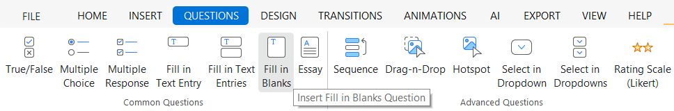

The very first step to create a Fill in Blanks quiz is inserting a Fill in Blanks question. So, do either of the following:
  • In the Questions tab > Fill in Blanks.
  • In the Home tab > Interactions > Fill in Blanks.
Fill in Blanks question on the Questions tab

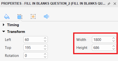

  • Resize the question title (1) and the answer area (2): You can resize these sections by selecting them and dragging the resizing handles. Alternatively, select them, then go to the Properties pane > Size & Properties tab > Transform to adjust or type the value in the Width and Height combo box:
Resize the question title and the answer area

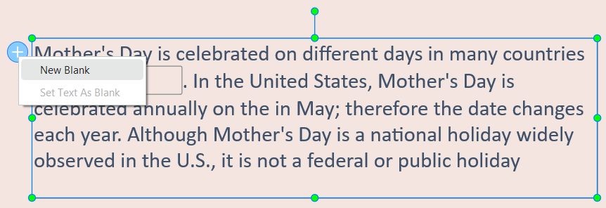

  • Insert a blank: After adding text to the answer area, click anywhere in the text where you want to add a blank, then click the green plus button and select New Blank.
Insert a blank
  • Set text as blank: ActivePresenter 10 also allows users to convert words or phrases in the text into blanks. To do that, select a word or a phrase, then, click the plus button and choose Set Text As Blank. Alternatively, you can right-click it and choose Set Text As Blank.
Set text as blank

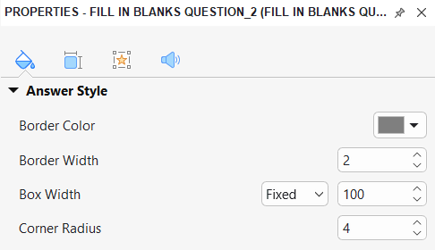

  • Format blanks: To change the blanks’ style, select the answer area or a blank > Properties pane > Style & Effects tab > Answer Style. Here, you can change the blanks’ properties such as Border Color, Border Width, Box Width, and Corner Radius.
customize the answer style
+ Border Color: Click the drop-down arrow to select another color.
+ Border Width: Enter a specific value (from 1 – 5) to change the border width of all blanks in pixels.
+ Box Width: Click the drop-down arrow to switch between the Auto and Fixed mode. With the Auto mode, the blank width will be automatically adjusted to the text length. Meanwhile, the Fixed mode allows users to change the box width of all blanks in pixels.
+ Corner Radius: Enter a specific value (from 1 – 10) to change the corner radius of all blanks in pixels.

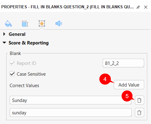

Set Correct Answers
To set a correct answer for a blank, simply type the correct answer into it.
Besides, take note that each blank can accept more than one correct answer. Follow these steps to set many correct values for each blank:
Step 1: Click on a blank. After that, open the Properties pane > Interactivity tab > Score & Reporting > Correct Values.
Step 2: Click the Add Value button (4)  to display a blank box, then type the correct answer into the box.
Perform Step 2 again to set as many correct values as you want for each blank.
set correct answer
If you set text as blank, the selected word or phrase is automatically set as a correct answer. Then, you can add more correct values to that blank following the above steps.
To remove any value, just click the Remove button (5).
Note: ActivePresenter 10 allows you to set Case Sensitive for each blank. If you select this option, the uppercase and lowercase characters will be treated differently.

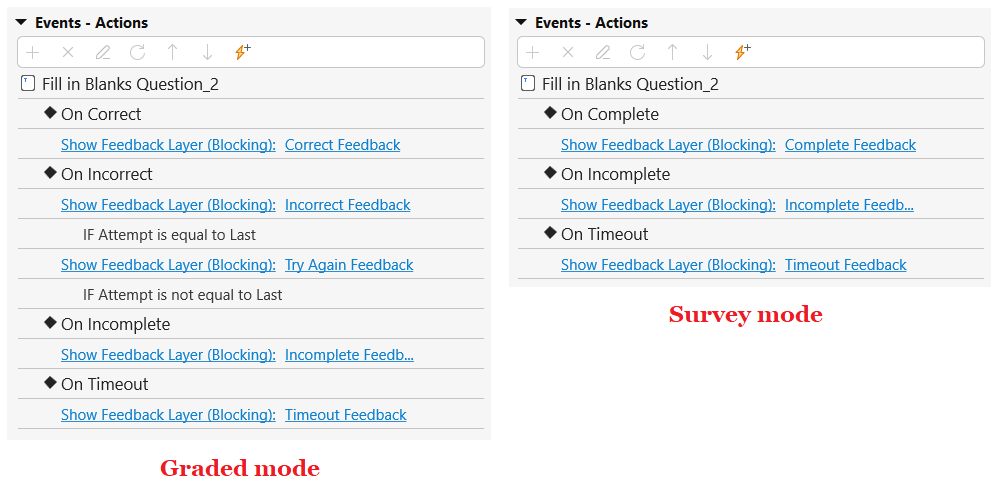

Add Events and Actions
ActivePresenter 10 offers default events and actions for Fill in Blanks questions in the quiz. Generally, this question type has four default events for the Graded mode (On Correct, On Incorrect, On Incomplete, and On Timeout) and three for the Survey mode (On Complete, On Incomplete, and On Timeout).
add events-actions to the fill in blanks question
You can remove, change, or make events and actions for this question more advanced as you wish. To do that, firstly, select the answer area. Then, access the Properties pane > Interactivity > Events – Actions.
Customize Feedback Layers
ActivePresenter also automatically adds default feedback layers for Fill in Blanks questions. These default feedback layers include Correct Feedback, Incorrect Feedback, Try Again Feedback, Incomplete Feedback, and Timeout Feedback (for the Graded mode) or Complete Feedback, Incomplete Feedback, and Timeout Feedback (for the Survey mode). See the above image for details. Note that you can delete, change, or add more feedback layers if necessary. To open feedback layers in ActivePresenter 10, in the View tab, click Feedback Master.
