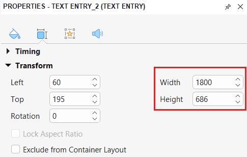

  • Resize the question title (1) and the answer area (2): Drag the resizing handles or adjust the Width and Height values in the Transform section (Properties pane > Size & Properties tab) to resize them.
Resize answer area.

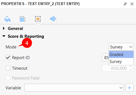

As mentioned above, learners are free to express their understanding to answer the question. So, it’s hard to set correct answers for it. It’s also the reason why the Survey mode is selected by default in the Score & Reporting section. This mode helps you to collect learners’ answers or feedback only.
On the other hand, ActivePresenter 10 still allows you to set correct answers for the question if you want. To do that, you have to switch to the Graded mode. Select the answer area > navigate to the Properties pane > Interactivity > Score & Reporting > select Graded from the Mode dropdown list (4).
Question modes of essay question

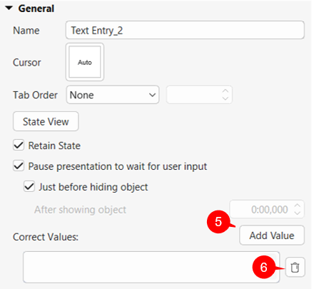

Then, take a look at the General section which is above the Score & Reporting section. Click the Add Value button (5) to display a blank box and type text into it. Do it again if you want to set more than one correct value to this question.
Add correct values
By contrast, to delete any correct values, simply click the corresponding Remove button (6).

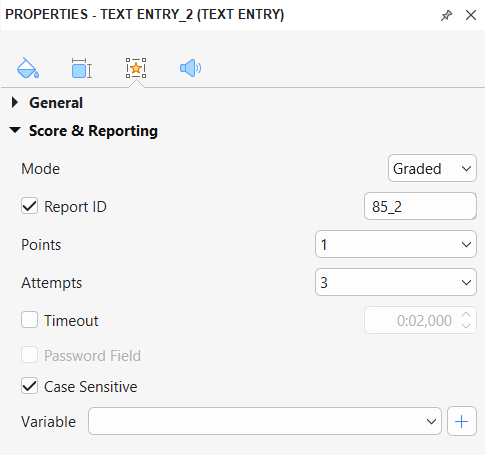

To set score and reporting for Essay questions, select the answer area > navigate to the Properties pane > Interactivity > Score & Reporting.
Set score and reporting for essay question
 This section provides a lot of useful options including:
  • Mode: Select the Graded mode if you want to measure learners’ performance, or select the Survey mode if you want to collect learners’ feedback or information.
  • Report ID: Track learners’ activities. You can edit it to a meaningful name so that you are easy to track in the report.
  • Points: Set points for correct answers. This option is only available if you select the Graded mode.
  • Attempts: Set the maximum attempts that learners can interact with the question. This option is also available if you select the Graded mode.
  • Timeout: Set a time limit that only allows learners to respond to the question in the given amount of time.
  • Case Sensitive: Select this option to differentiate uppercase and lowercase characters.
  • Variable: Define the variable to take place.

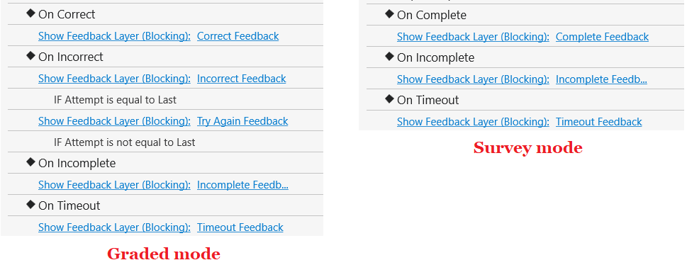

ActivePresenter 10 offers default events and actions for Essay questions. Generally, this question type has four default events for the Graded mode (On Correct, On Incorrect, On Incomplete, and On Timeout) and three for the Survey mode (On Complete, On Incomplete, and On Timeout).
Add events - actions to essay question
You can remove, change, or add new events and actions the way you want. To do that, select the answer area > navigate to the Properties pane > Interactivity > Events – Actions.
