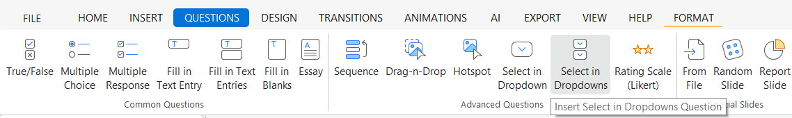

Insert a Select in Dropdowns Question
Do one of the following ways to insert a Dropdowns question:
  • Open the Questions tab > Select in Dropdowns.
  • Open the Home tab > Interactions > Select in Dropdowns.

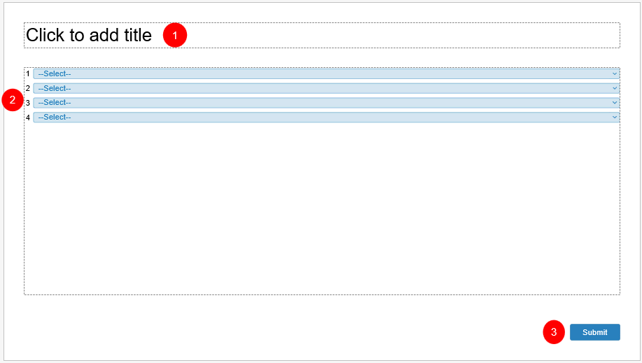

After that, a new question slide will appear with three parts as below:
new select in dropdowns question slide
  • (1) The top text box where you can input the question title.
  • (2) The answer area with 4 default dropdowns which learners can select options from.
  • (3) The Submit button.

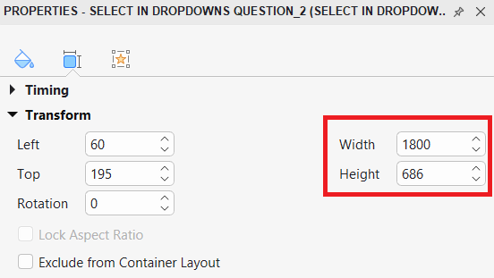

Resize the Question Title (1) and the Answer Area (2)
Simply drag the resizing handles of the top text box or the answer area on the Canvas to resize them. Alternatively, select them > Properties pane > Size & Properties tab > Transform section. Then, adjust the values in the Width and Height combo box:
Resize

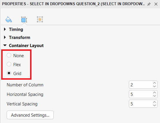

Customize the Answer Area
  • Change the container layout: Select the answer area > Properties pane > Size & Properties tab > Container Layout section > select None or Flex.
Change select in dropdowns question's layout

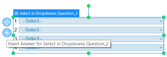

  • Add more dropdowns: Select the answer area and click the Plus button:
insert answer for select in dropdowns question

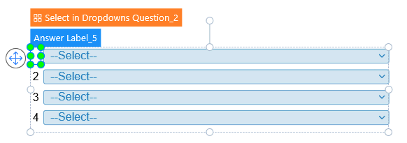

  • Rename the answer labels: The answer labels are numbers by default. You can rename them by clicking them, and entering new names.
rename answer labels

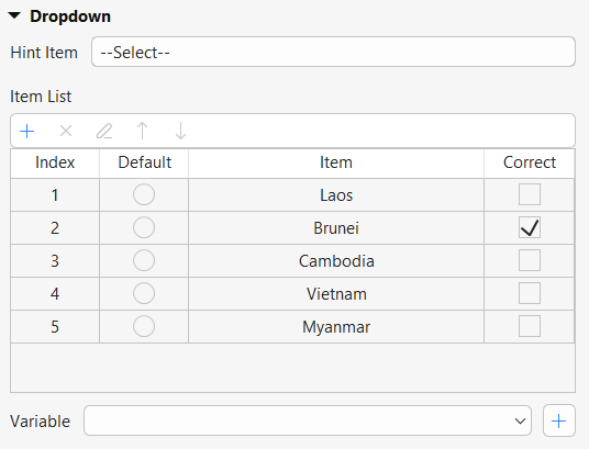

To add and customize the item list for Select in Dropdowns questions, select a dropdown > navigate to the Properties pane > Interactivity tab > Dropdown section, then:
  • Hint Item: Click to customize the default text to a meaningful one if you want.
  • Add a new item: Click the Add button. Repeat this work until you fill in all desired items.
item list of a select in dropdowns question
  • Remove an item: Select an item and click the Remove button if you no longer need it.
  • Edit an item: Double-click an item, or select it and click the Edit button.
  • Move an item up: Select it and click the Move Item Up button.
  • Move an item down: Select it and click the Move Item Down button.
  • Index: Identify the sequence of items.
  • Default: Display one item on the dropdown instead of the default text. Select the corresponding radio button of the item you want to show.
  • Item: Show the list of items.
  • Correct: Allow you to set the correct values by checking the corresponding checkboxes.
  • Variable: Define a text variable here to take place.

Similar to other question types, you can easily set correct answers for a Select in Dropdowns question. As described in the previous part, just select each dropdown > Properties pane > Interactivity tab > Dropdown section. After that, tick the checkboxes of the items which you want to set as correct answers in the Item List.

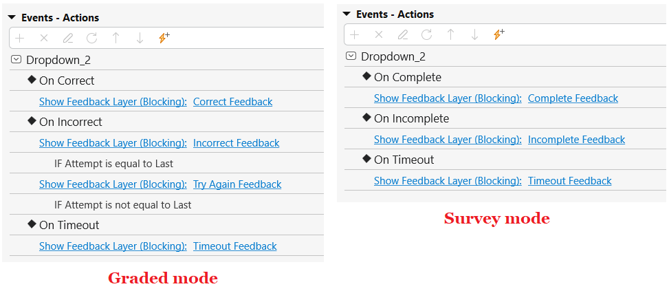

Add Events – Actions
ActivePresenter 10 adds some default events – actions for a Select in Dropdowns question. For the Graded mode, this question type has 4 events. They are On Correct, On Incorrect, On Incomplete, and On Timeout. Meanwhile, the Survey mode has 3 events including On Complete, On Incomplete, and On Timeout.
set events - actions for select in dropdowns question
Besides, you are free to add more, edit, or delete any events – actions if you want. To do that, select the answer area > navigate to the Properties pane > Interactivity tab > Events – Actions section.
