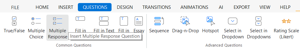

Insert a Multiple Response Question
To insert a Multiple Response question, do either of the following:
  • Open the Questions tab > Multiple Response .
  • Open the Home tab > Interactions > Multiple Response .

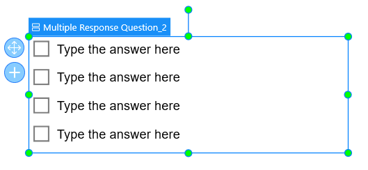

Then, a new question slide inserted into your project as in the below image:
Multiple response question slide
As you can see, the question slide has three parts:
  • (1) the top text box to add the question title;
  • (2) the answer area with four default answer options;
  • (3) and the Submit button.

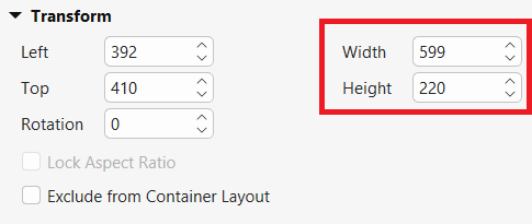

  • Resize the question title (1) and the answer area (2): Drag the resizing handles on the Canvas, or select them > Properties pane > Size & Properties > Transform > adjust the Width and Height values.

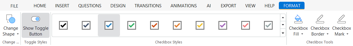

  • Edit toggle buttons: Each answer option comes with a checkbox. Freely format them by selecting a built-in style in the Checkbox Styles gallery or editing it using Checkbox Tools.

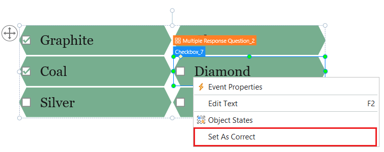

Set Correct Answers for Multiple Response Questions
To set correct answers to the question, double-click the corresponding checkboxes. Alternatively, right-click each correct answer option > Set As Correct.

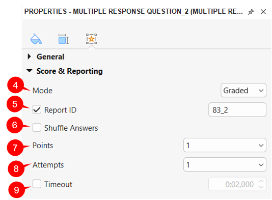

Set Score and Reporting
To set score and reporting for this question type, select the answer area, then navigate to the Properties pane > Interactivity > Score & Reporting.
Set score and reporting for multiple response questions
This section provides a lot of useful options to customize as follows:
  • (4) measure learners’ performance (select the Graded mode) or collect learners’ feedback or information (select the Survey mode);
  • (5) track learners results;
  • (6) mix up answer options each time learners access the question;
  • (7) set points for correct answers;
  • (8) set the maximum attempts that learners can interact with the question;
  • (9) set a time limit that requires learners to respond to the question in this amount of time.

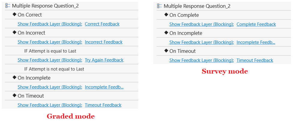

Add Events and Actions
Similar to other question types, Multiple Response also has events – actions added by default. Particularly, it has 4 default events for the Graded mode (On Correct, On Incorrect, On Incomplete, and On Timeout) and 3 for the Survey mode (On Complete, On Incomplete, and On Timeout).
Add events-actions for multiple response questions
However, you are free to add more, edit or delete any events – actions the way you want. To do that, select the answer area > navigate to the Properties pane > Interactivity > Events – Actions.
