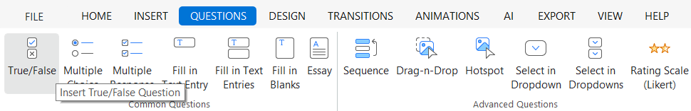

To add a True or False question to your project, you open the Questions tab and select True/False. Alternatively, in the Home tab > Interactions > True/False.

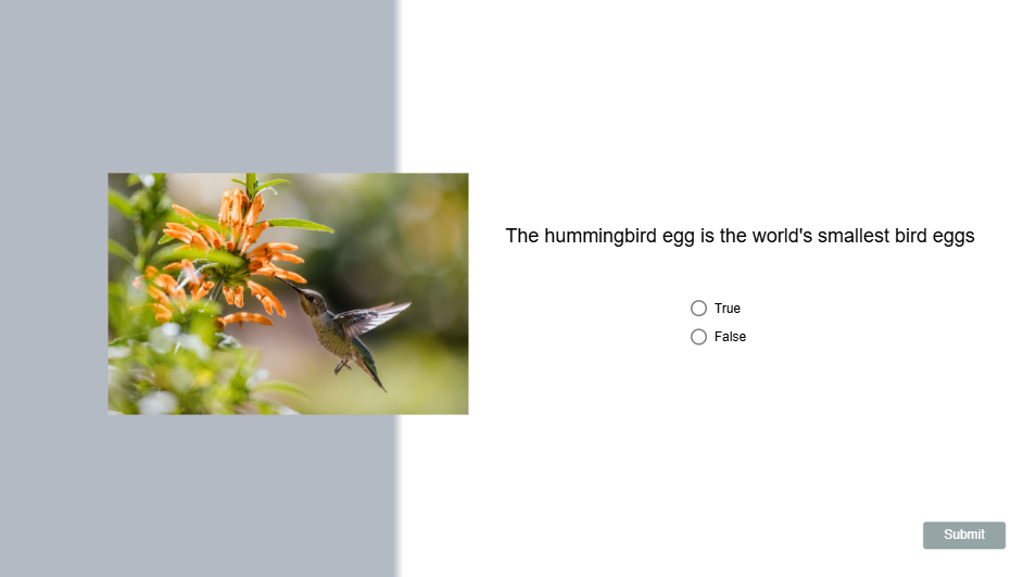

True or false

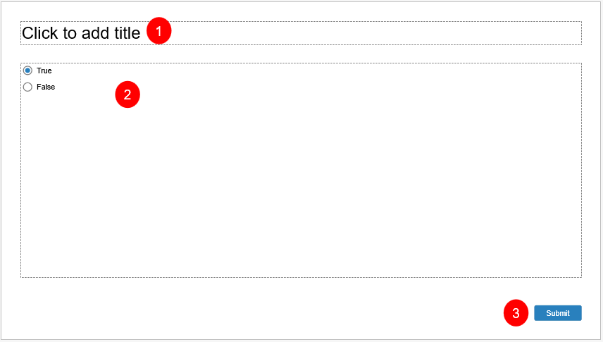

Then, a new question slide including 3 sections is inserted into your project like below:
true false quiz in ActivePresenter
(1): The top text box to add the question title
(2): The answer area with two default answer options: True – False
(3): The Submit button.

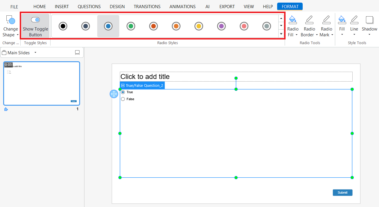

1. Style Text and Radio Buttons
  • Add question title: You type the question title into the top text box. Then, style the text using the inline text editor that appears or the Font section of the Home tab.
  • Edit/Add text to answer options: By default, the answer options are named True – False. However, you’re free to rename them. For example, you can change the text to Yes – No, Correct – Incorrect, Right – Wrong, or whatever you want.
  • Style buttons: To style the radio buttons in the answer area or the Submit button, you can navigate to the Format tab and select a built-in style or design your own.

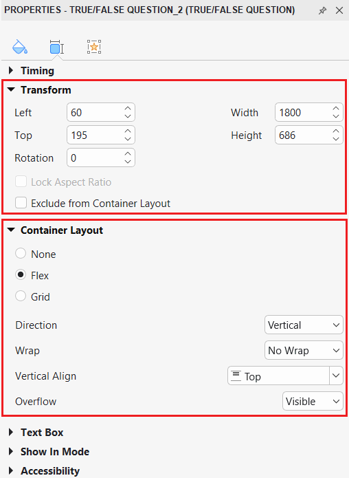

  • Change the container layout: By default, a question is set in the container layout. To change the question container layouts, select the answer area and access the Properties pane > Size & Properties tab > Container Layout. In this section, ActivePresenter 10 offers you three options: None, Flex, or Grid. Select the layout mode that you want. Then, you can customize its properties.
  • Rearrange the question position: On the Canvas, drag the question to a new position. Or, specify the values in the Transform section in the Size & Properties tab of its Properties pane.

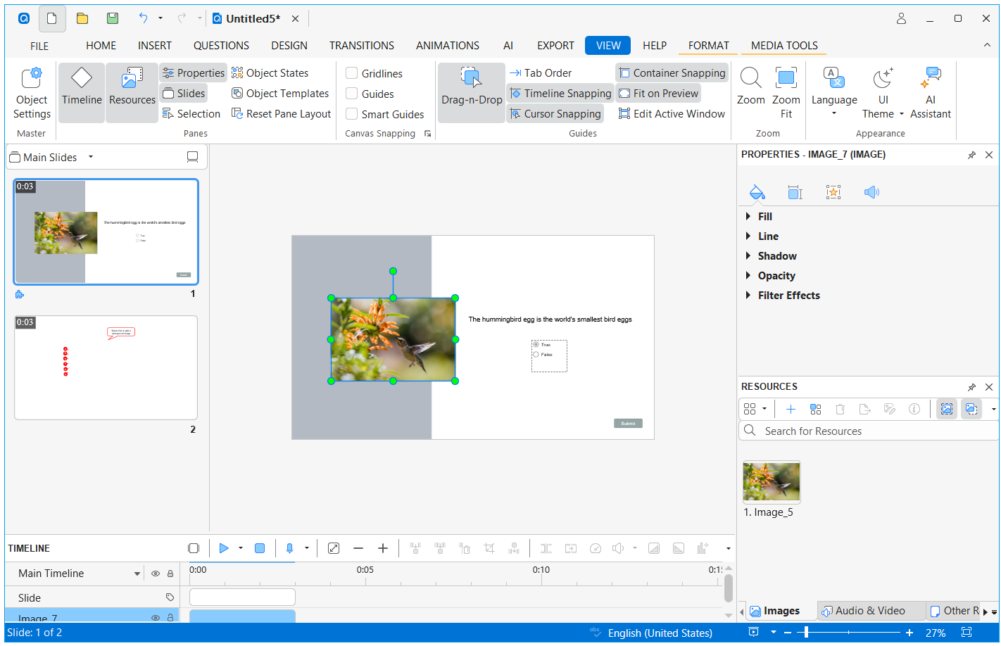

3. Complement with Shapes, Images, Videos, or Audio
You can freely add resources such as shapes, images, videos, audio, and more to your question by accessing the Insert tab, or simply dragging and dropping them from your computer to Canvas.

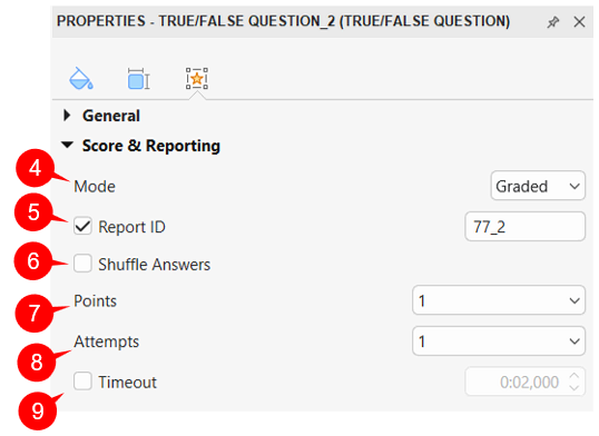

  • To set the score and reporting for a True/False question, select the answer area of the question. Then, go to the Properties pane > Interactivity tab > Score & Reporting.
set score and report
This section provides a lot of options to:
(4) measure learners’ performance (select the Graded mode) or collect learners’ feedback or information (select the Survey mode);
(5) track learners’ results;
(6) mix up answer options when the question is presented to learners;
(7) set points for correct answers;
(8) set the maximum number of attempts that learners can interact with the question;
(9) set a time limit that only allows learners to respond to the question in the given period.

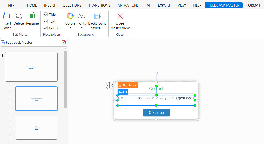

ActivePresenter automatically adds default feedback layers for a True or False question. To open them, in the View tab, select Feedback Master. Then modify them as you wish.
The default feedback layers can be Correct Feedback, Incorrect Feedback, Try Again Feedback, Incomplete Feedback, and Timeout Feedback (for the Graded mode) or Complete Feedback, Incomplete Feedback, and Timeout Feedback (for the Survey mode). Note that you can delete, change, or add more if necessary.

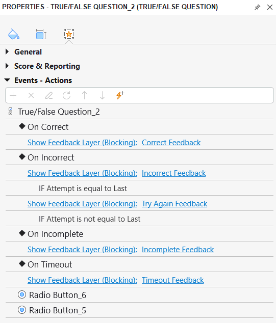

6. Set Events – Actions
ActivePresenter offers default events and actions for True/False questions. Generally, a True or False quiz has four default events for the Graded mode (On Correct, On Incorrect, On Incomplete, and On Timeout) and three for the Survey mode (On Complete, On Incomplete, and On Timeout).
If you select the Graded mode, here is what you see in the Properties pane:
events actions
You can remove, change, or make events and actions for True/False questions more advanced as you desire. To do that, first, select the answer area. Then, access the Properties pane > Interactivity tab > Events – Actions.

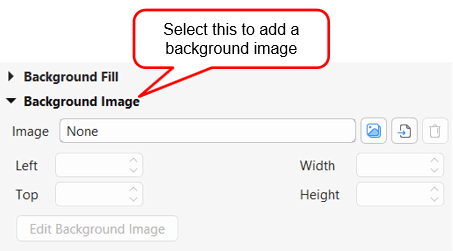

  • Adding a background image from the Background Image section instead of Background Fill > Image will improve the loading speed.

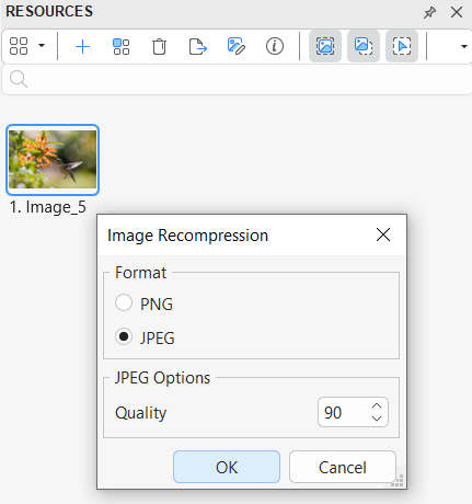

  • To optimize your time creating this question, you can drag and drop the resources from your computer into the Resources pane. After that, instead of repeatedly searching for the image and audio objects in the folder on your computer, you may choose them directly from the Resources pane.
  • To recompress high-resolution images, right-click on them in the Resources pane and select Recompress.
