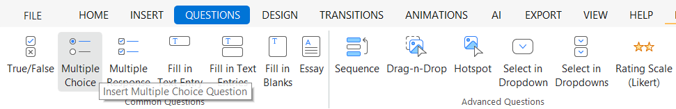

In ActivePresenter 10, Multiple Choice is the second question type you can see in the Questions tab. To insert a Multiple Choice question, do either of the following:
  • In the Questions tab > Multiple Choice
  • In the Home tab > Interactions > Multiple Choice
Add Multiple Choice Question

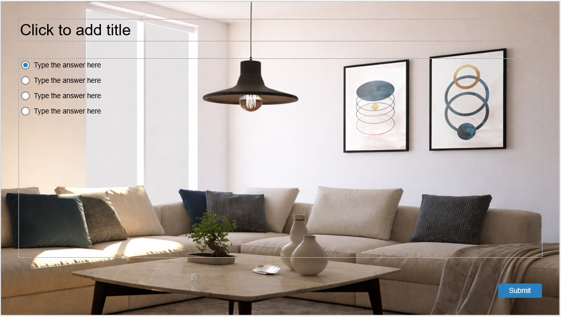

Then, a new Multiple Choice Question slide including the top text box (1), answer area(2), and submit button (3) is inserted into your project as in the image below:
Multiple Choice Question Slide

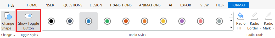

  • Style buttons: To style the radio buttons in the answer area or the Submit button, you can navigate to the Format tab and select the radio style you like or customize it as you wish.
style text
Note: After selecting the correct answer, you can hide the radio buttons by selecting Show Toggle Button. Then, freely customize the answer area as you wish.

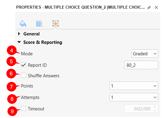

5. Set Score and Reporting
To set a score and report for a Multiple Choice question, select the answer area of the question. Then, go to the Properties pane > Interactivity tab > Score & Reporting.
How to Set Score and Reporting for Multiple Choice Questions
This section provides a lot of helpful options to:
(4) measure learners’ performance (select the Graded mode) or collect learners’ feedback or information (select the Survey mode);
(5) track learners’ results;
(6) mix up answer options when the question is presented to learners;
(7) set points for correct answers;
(8) set the maximum number of attempts that learners can interact with the question;
(9) set a time limit that only allows learners to respond to the question in the given period.

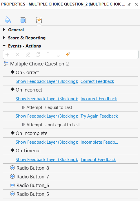

7. Set Events – Actions
ActivePresenter 10 offers default events and actions for Multiple Choice questions. Generally, a Multiple Choice question has four default events for the Graded mode (On Correct, On Incorrect, On Incomplete, and On Timeout) and three for the Survey mode (On Complete, On Incomplete, and On Timeout).
If you’ve selected the Graded mode, here is what you’ll see:
How to Set Events - Actions for Multiple Choice Questions
You can remove, change, or make events and actions for Multiple Choice questions more advanced as you wish. To do that, first, select the answer area. Then, access the Properties pane > Interactivity tab > Events – Actions
