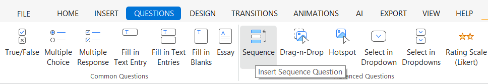

To insert a Sequence question, do either of the following:
  • Open the Questions tab > Sequence.
Questions tab

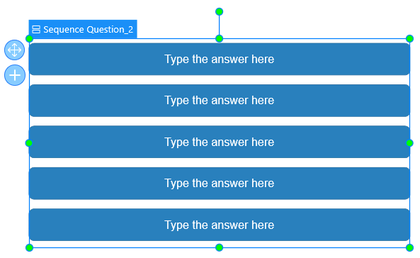

As you can see, it has three parts:
  • (1) the top text box to add the question title;
  • (2) the answer area with five default answer labels;
  • (3) and the Submit button.

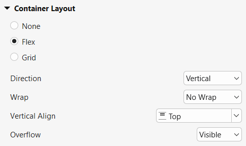

  • Change the container layout: Select the answer area > Properties pane > Size & Properties tab > Container Layout > select one of three options:
    • None: This option allows you to resize and reposition answer options freely.
    • Flex: This layout arranges answer options horizontally or vertically in a flex container.
    • Grid: This option is selected by default. It arranges answer options in the grid pattern.

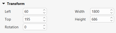

  • Resize the question title (1) and the answer area (2): Drag their resizing handles, or change the Width and Height values in the Transform section (Properties pane > Size & Properties tab).
Resize the question title and the answer area
  • Insert more answer labels: Select the answer area (2) and click the plus button:

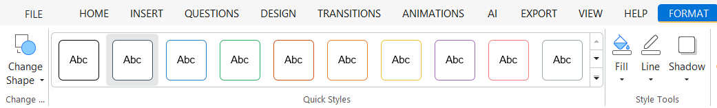

  • Edit answer labels: Select the answer area > Format tab > select one built-in style from the Quick Styles section, or use tools in the Style Tools tab.
Format answer labels

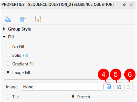

  • Add images to answer labels: Click an answer label > Properties pane > Style & Effects tab > Fill >Image Fill. Then, click the button (4) to select an image from the current project, or click the button (5) to import an image from your computer. If you want to remove it, simply click the button (6).
Image Fill

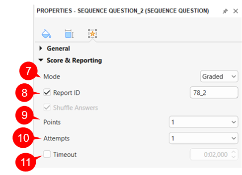

To set score and reporting for a Sequence question, select the answer area > Properties pane > Interactivity tab > Score & Reporting.
Set score and reporting
This section provides some question properties that you can customize:
  • (7) Mode: Select the Graded mode to measure learners performance. Otherwise, select the Survey mode to collect learners feedback or information.
  • (8) Report ID: Track learners’ results. You can rename it to a meaningful name.
  • (9) Points: Set points for correct answers.
  • (10) Attempts: Set the maximum attempts that learners can interact with the question.
  • (11) Timeout: Select this checkbox and enter the time duration into the box to set a time limit to the question.

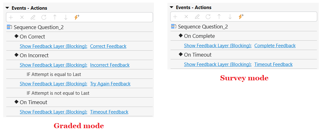

ActivePresenter 10 also offers default events and actions for Sequence questions. Generally, a Sequence question has three default events for the Graded mode (On Correct, On Incorrect, and On Timeout) and two for the Survey mode (On Complete, and On Timeout).
Add events - actions to Sequence questions
However, you can remove, edit, or add more to make it interactive the way you want. To do that, select the answer area > Properties pane > Interactivity tab > Events – Actions.
