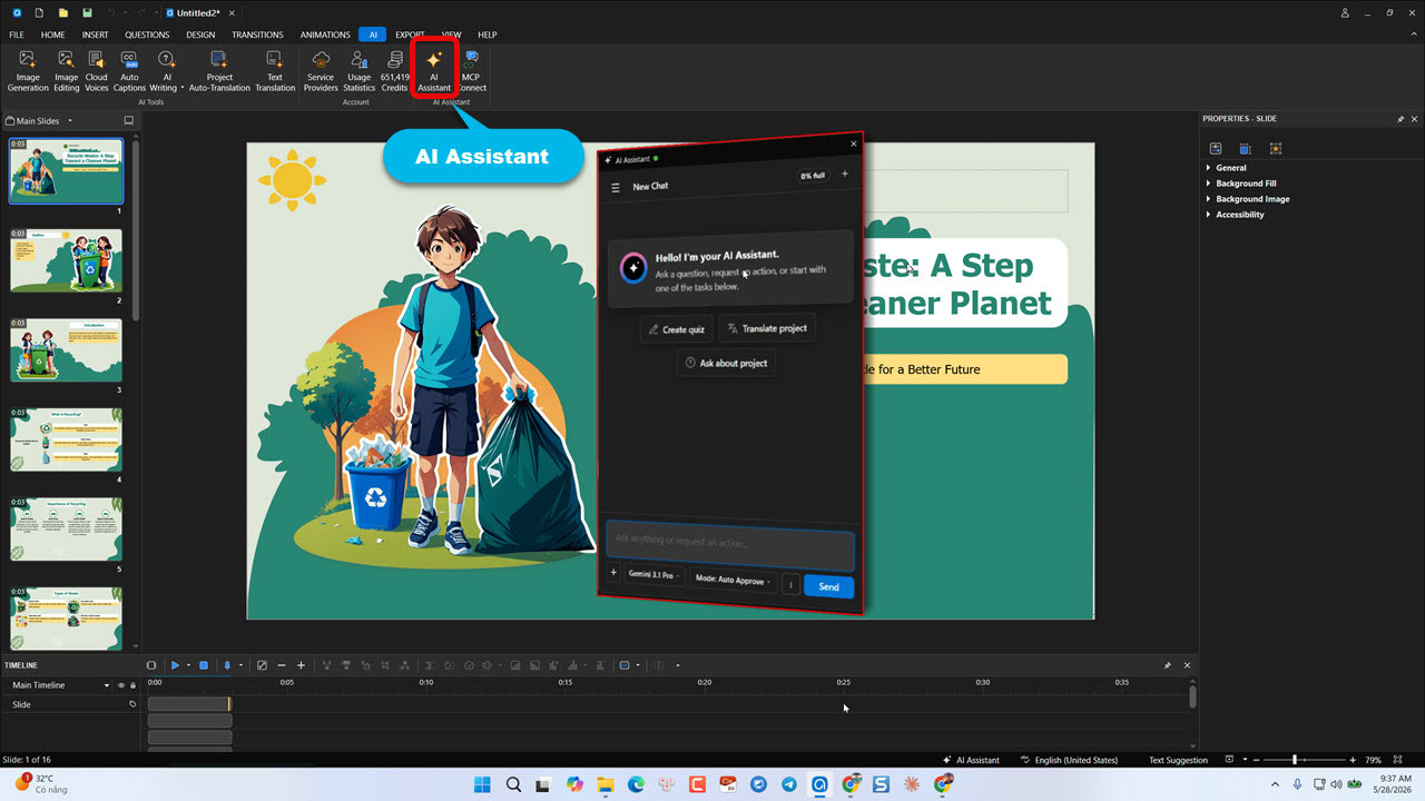

Step 1: Open the New AI Assistant Pane
ActivePresenter 10.5 features a completely overhauled AI workspace panel designed for conversational authoring.
  1. Launch ActivePresenter 10.5 and open or create a project.
  2. Navigate to the top ribbon and select the AI tab.
  3. Click on AI Assistant to toggle open the dedicated chat sidebar pane.

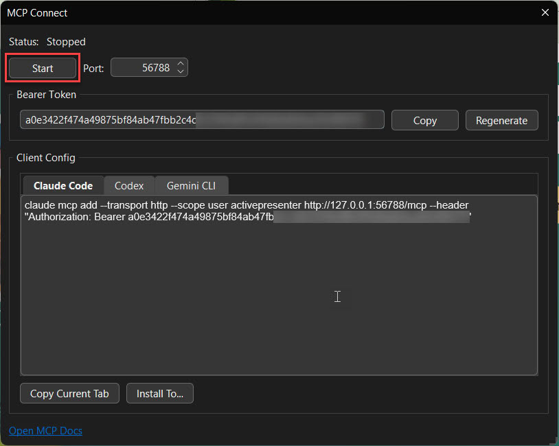

🛠️ Common Prerequisite Step
Before connecting any individual agent, you must initialize ActivePresenter’s local communications pipeline:
  1. Open ActivePresenter 10.5 and navigate to the AI tab on the top ribbon.
  2. Click MCP Connect to open the panel, then open Settings > MCP Connect.
  3. Toggle the connection switch to START (this starts the local server listener, exposing the project context securely to your system loop).
Follow these step-by-step connection workflows for your preferred developer agent:

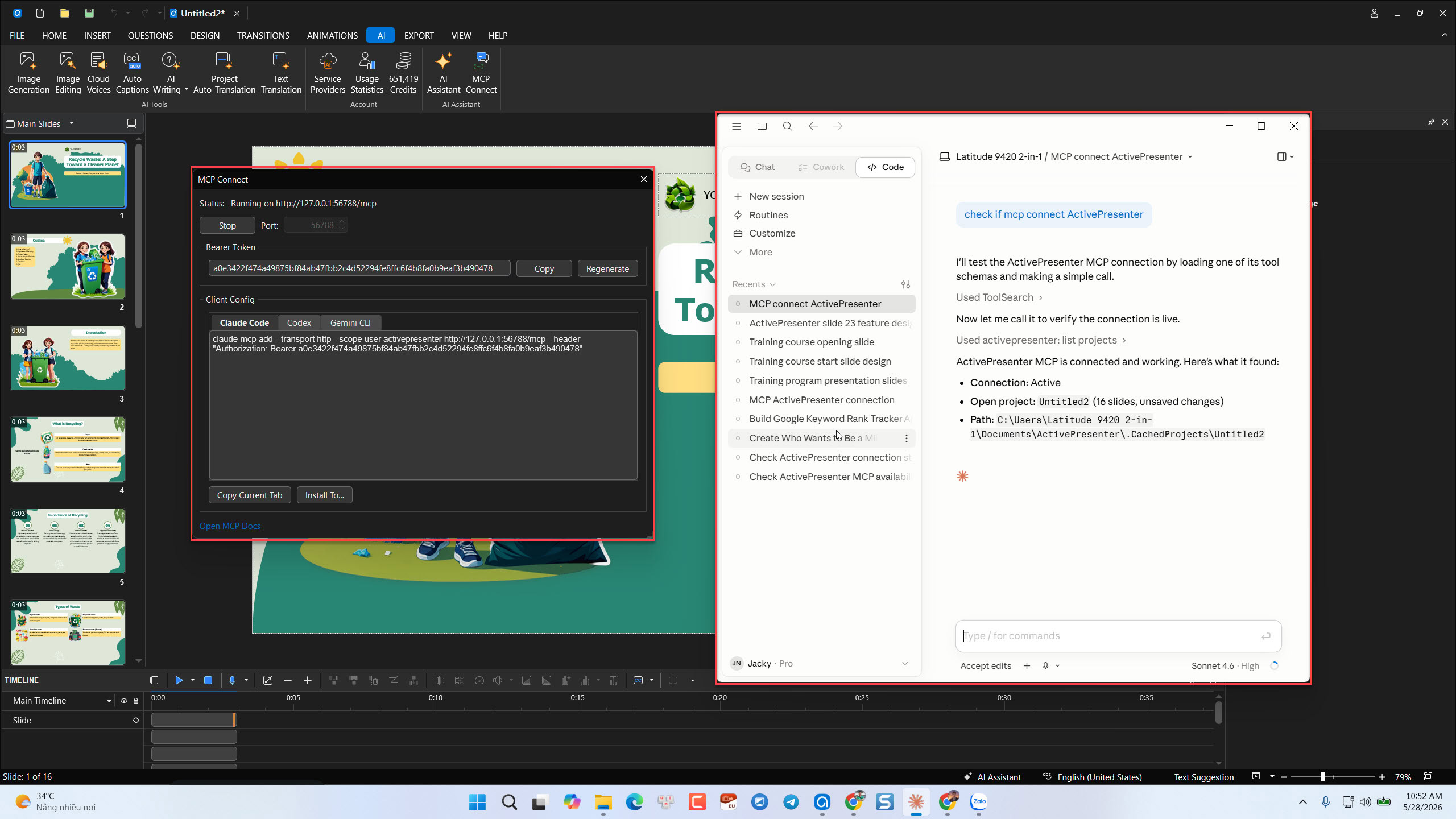

1. Connecting & Controlling via Claude Code
Claude Code is exceptionally powerful at understanding deep project contexts, auditing instructional schemas, and executing multi-step automation sequences to design slides or compile course assets.
In order to install Claude Code on your device, follow the instructions at this url: https://code.claude.com/docs/en/quickstart
Once your Claude code is ready, you can simply check if Claude Code is connected to ActivePresenter or not with a simple prompt: “check MCP Connect with ActivePresenter”
⚠️ Special Notes for Claude Code Integration:
  • ActivePresenter Server Verification: Before running your connection scripts in the terminal, check the configuration window you opened via AI > MCP Connect and make sure the MCP status explicitly reads “Running”. If the local server pipeline is not actively running, the external agent will not be able to find or sync with your project canvas.
  • Anthropic Account Subscription Requirements: Claude Code is not accessible on standard free-tier Anthropic accounts. To utilize this command-line tool, you must have an active paid developer subscription tier (Claude Pro or Claude Max) with available usage balance under your Anthropic account.

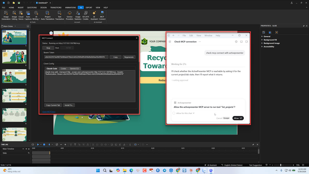

2. Connecting & Controlling via OpenAI Codex
OpenAI Codex specializes in transforming complex, natural language instructional logic into interactive slide builds and fully mapped, variable-driven quiz modules.
In order to install OpenAI Codex on your device, follow the instructions at this url: https://platform.openai.com/docs/guides/code-generation
Once your OpenAI Codex is ready, you can simply check if OpenAI Codex is connected to ActivePresenter or not with a simple prompt: “check MCP Connect with ActivePresenter”
⚠️ Special Notes for OpenAI Codex Integration:
  • OpenAI Account & API Key Requirements: OpenAI Codex requires a ChatGPT account or valid API Key linked to an active developer account. To utilize this integration seamlessly without hitting standard rate limits, you must have an active paid tier account with an available usage balance or credit tokens under your OpenAI platform billing profile.

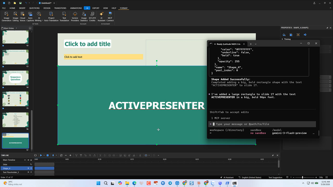

3. Connecting & Controlling via Gemini CLI
The Google Gemini CLI pipeline thrives on processing massively long context strings, making it the ideal choice when you want the AI to read an entire e-book or massive technical manual and instantly map out an organized course architecture.
In order to install Gemini CLI on your device, follow the instructions at this url: https://geminicli.com/
Once your Gemini CLI is ready, you can simply check if Gemini CLI is connected to ActivePresenter or not with at the command prompt:
⚠️ Special Notes for Gemini CLI Integration:
  • Google AI Studio / Cloud Requirements: The Gemini CLI relies on active project authentication. You must have a verified Google AI Studio account or Google Cloud Project with the Gemini API enabled, alongside a valid API token or billing setup to handle advanced automated tasks.
