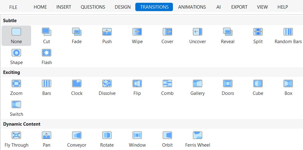

Step 1: Select one or more slides that you want to add a transition.
Step 2: Access the Transitions tab.
add transition for slide
Step 3: Hover the mouse over each transition effect and hold the mouse still for a second to let the effect run in the preview mode automatically.
Step 4: Select the effect you’re satisfied with.

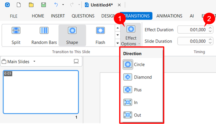

Step 5: Set more effects for the selected transition by clicking the Effect Options button (1).
Add transition effects for slide
Note
  • Effect Options vary from effect to effect. For example, the Doors effect includes Vertical and Horizontal options. Meanwhile, the Shape effect includes 5 options which are CircleDiamondPlusIn, and Out.
  • Transitions like Flash and Dissolve have no effect options. Therefore, you will see the Effect Options button appearing dimmed when selecting one of these two transition effects.

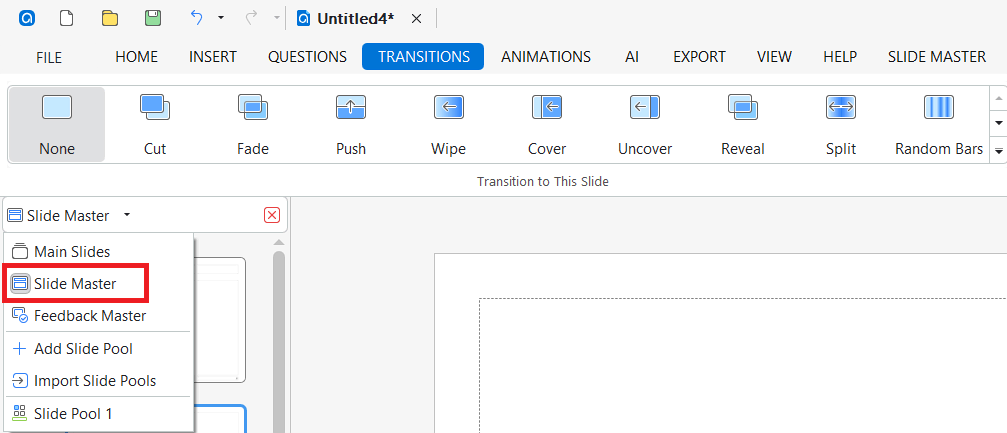

If you want to add a transition to a specific slide layout, or apply the same transition effect to all your slides, you can do it in only one place – the Slide Master. Do the following steps:
Step 1: Open the Slides pane and click Slide Master
Insert transition effect in Slide Master
Step 2: Select the master layout or any custom layout that you want to apply transition effects. Then, in the Transitions tab, choose an effect from the gallery and its effect option (if any).
Note: When you edit the master layout, the changes will apply to all custom layouts that are based on that master, except for the layouts already having transitions.

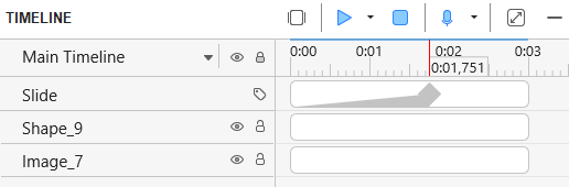

After adding a transition effect, you can preview it by clicking the Play button in the Timeline. Or click HTML5 Preview to see it in the browser. Chances are you want the effect to be faster or slower, simply change its duration. Perform either of the following:
  • Enter a value in the Effect Duration spin box (2) or click the up/down arrow to increase/decrease the value.
  • Drag the blue diamond (3) to the left or right in the Timeline pane. The light blue area stretching from the starting point of the slide to the blue diamond indicates the duration of the effect. The longer it is, the slower the effect happens, and vice versa.
Change transition duration
Note: The duration of the transition effect should be shorter than the slide duration.
