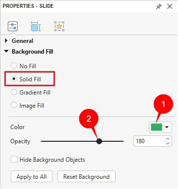

Apply a Solid Color to Slide Background
Step 1: Navigate to the Properties pane > Slide Properties tab > Background Fill section > select Solid Fill.
Step 2: Click Color (1) and choose the color you want. You can use an available background color in the Theme Colors or Standard Colors section. Besides, click More Colors to create a custom color, or use Eyedropper to select a color you want to match and apply to selected slides.
Step 3: (Optional) Drag the Opacity slider (2) to change the opacity level of the background. Alternatively, enter your desired value in the Opacity spin box or click the up/down button to increase/decrease the value.

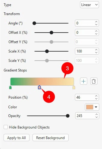

Linear Gradient
This gradient type is selected by default. It consists of two default color stops: black and white. But you can change the colors and add as many color stops as you want to create different linear gradient effects.
Change slide background, linear gradient.
To work with a linear gradient, mind the following:
  • Angle: Set the angle of direction for the gradient line. By default, a linear gradient runs horizontally from left to right with an angle of 0 degrees. 90 degrees creates a top-to-bottom vertical gradient. As the degree increases, the gradient direction rotates clockwise.
Customize linear gradient.
  • Offset X (%, range from -100 to 100): Drag the Offset X slider to the right or left to change the position of gradient stops horizontally. Or, input the value into the spin box.
  • Scale X (%, range from 10 to 250): Drag the Scale X slider to the right or left to change the width of gradient colors, or input the value into the spin box. When the value is “10”, the width of gradient colors is minimum. When the value is “250”, this value is maximum.
  • Gradient strip (3): Display the preview of the gradient. Use it to make visual changes to the gradient.
  • Color stop: Represent a color. The selected color stop has a blue border (4). To add a color stop, click on the strip or click the Add button. To delete a color stop, select it and click the Remove button.
  • Position (%): Specify the position of the selected color stop, where you want to color to start. Alternatively, drag the color stops along the strip to do that. By default, the starting and ending color stop has a position of 0% and 100% respectively.
  • Color: Display the color of the selected color stop.
  • Opacity: Change the opacity level of the selected color stop.

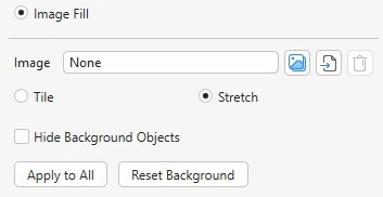

Import an Image as Slide Background
Otherwise, ActivePresenter 10 allows you to fill a slide with an image. You can select an image from the current project or import it from your file system.
After that, select either Tile or Stretch:
  • Tile: Repeat the same image throughout the background, making multiple tiles of the image. This is meant for small images.
  • Stretch: Extend the image to all edges of the slide by distorting or shrinking it.
These two options are useful as the image’s dimensions don’t match the slide size.
Besides, select Apply to All to fill that image as the background of all slides in the current project. If you want to discard the changes, click the Reset Background button.

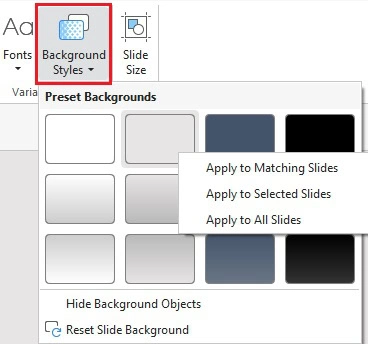

2. Use Background Styles
As you may know, ActivePresenter 10 offers 12 Preset Background Styles. These background styles vary from theme color to theme color that you’ve applied to the current project. So, to change the slide background, select your slides > open the Design tab > select Background Styles.
Then, select the style you want, or right-click a style and choose any of the following:
  • Apply to Matching Slides: Work the same as when you click a style.
  • Apply to Selected Slides: Apply the background style to currently selected slides only. The option comes in handy when you want to apply different styles to different slides.
  • Apply to All Slides: Apply the background style to all slides in your working project.

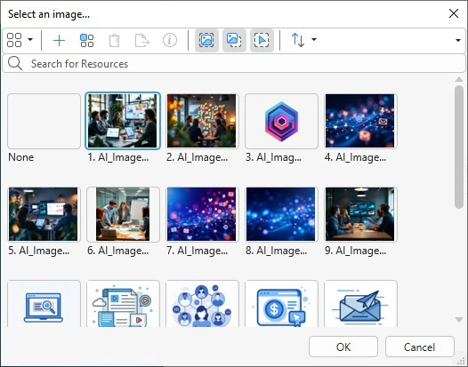

  • Click Select a background image from project button to select an image from the current project. Then, the Select an image… dialog appears. You can choose any image you want.
  • Click the OK button to import an image from your file system.
Then, you see the new image inserted into the selected slide.

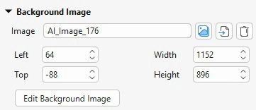

If the imported image is larger than the slide size, it will be cropped. For this reason, ActivePresenter 10 lets you change the background image position and size (in px or %).
  • Left: Specify the X position of the background image from the top-left corner.
  • Top: Specify the Y position of the background image from the top-left corner.
  • Width: Display the original width of the background image, but it’s changeable.
  • Height: Display the original height of the background image, but it’s changeable.
To further edit the background image, click Edit Background Image and choose one of the following options:
  • Restore Original Size: Restore the image to its original dimensions.
  • Fit to Slide: Resize the image so that it fits the slide size.
  • Edit on Canvas: Allow you to edit the background image directly on the Canvas like a normal object.
If you want to remove the background image from the current slide, click the Remove the background image button.

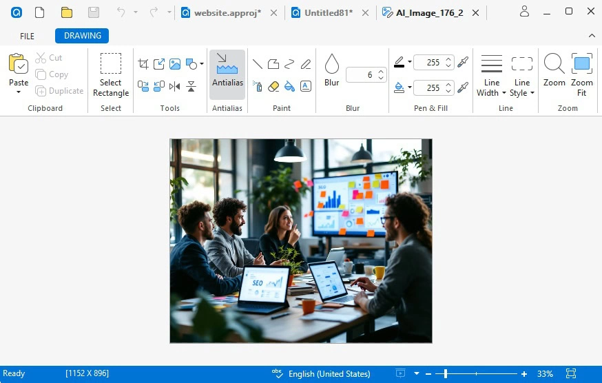

As mentioned above, ActivePresenter 10 allows you to edit the background image right inside the app. This feature is useful when you record interactive simulations. To open the Image Editor, right-click the background image, and select Edit Background Image.
Then, the Image Editor appears like this:
As you can see, the Drawing tab brings you a variety of image editing commands. These commands are very common, so editing the background image may come naturally to you. After finishing editing, click the File > Save button to save the changes. Then, back to the current slide, you will see the new background image.
