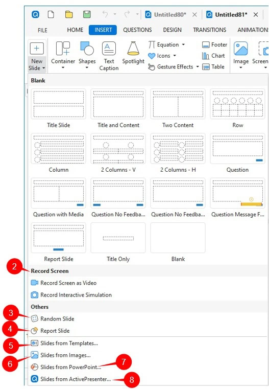

There are numerous ways to add slides in ActivePresenter 10 eLearning software.
(1) Insert Blank Slides
(2) Insert Slides from Recording Screen
(3) Insert Random Slides
(4) Insert Report Slides
(5) Insert Slides from Templates
(6) Insert Slides from Images
(7) Insert Slides from PowerPoint
(8) Insert Slides from ActivePresenter

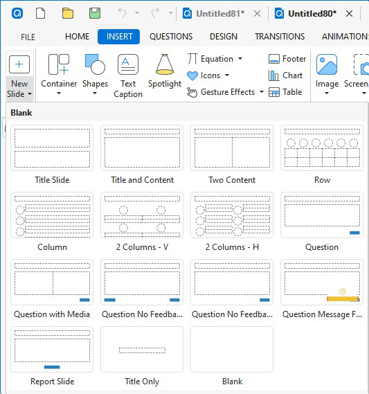

1. Insert New Blank Slides
To add a new blank slide into your current project, do either of the following ways:
  • Open the Home tab > New Slide > Blank.
  • Open the Insert tab > New Slide > Blank.
Then, select a desired slide layout from the Blank section. After that, a new blank slide will be added to your current project.

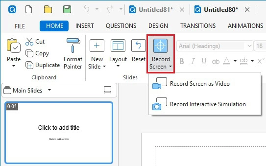

2. Insert New Slides from Recording Screen
ActivePresenter 9 also lets you add the newly recorded video as a new slide into your current project. To add a slide from the recording screen, do one of the following ways:
If you select the Record Video as Video mode, you will get a slide containing a video after recording. Otherwise, with the Record Interactive Simulation mode, it allows you to capture all actions on the screen and then convert them into a slide-based project including:
  • Image slides (mouse click, keystroke);
  • Video slides (mouse scroll, drag-n-drop).
To stop recording, press CTRL+END (for Windows) or ⌥⌘2 (for macOS). Alternatively, you can click the ActivePresenter icon in the system tray to open the Recording Toolbar dialog > Stop Recording. After that, ActivePresenter 9 moves you to the editor immediately.
  • If you choose Record Video as Video, a new slide with a recorded video will appear in your current project.
  • If you choose Record Interactive Simulation, a series of slides containing steps that you have performed will appear in your current project. They can be image slides or video slides, depending on your actions.
3. Insert Random Slides
Using random slides is extremely useful in creating online tests as it makes slides appear randomly. So, each time learners take the test, the order of these questions is different. Thanks to that, you can prevent learners from cheating on the test.
Adding random slides can be done if your project has question pools already. Question pools can be created in this project or imported from others.
To add a random slide, do either of the following:
  • Open the Home/Insert tab > New Slide > Others section > Random Slide.
  • Open the Questions tab > Random Slide.
After that, a slide with gray background appears and links to the first question pool by default. You can link it to another pool by navigating to the Properties pane > Slide Properties tab > Linked Pool > selecting another one.
4. Insert Report Slides
The report slide comes in handy when summarizing the learners’ performance and giving them feedback. To add a report slide, open the Home/Insert tab >New Slide >Others section > Report Slide. Another way is to open the Questions tab > Report Slide. Then, it will be added to your project like this:

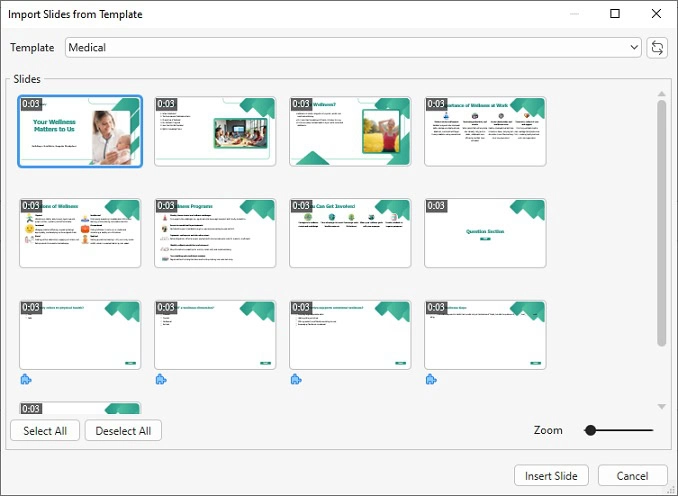

5. Insert New Slides from Templates
Similar to adding random slides, this way also requires you to create your own slide templates in advance. To insert slides from templates, open the Home/Insert tab > New Slide > Others section > Slides from Templates… Then, the Import Sides from Template dialog appear for you to select from:
  • Click the Template drop-down button to choose your favorite template. In addition, you can click the Refresh button next to it to update this list.
  • Select one or more slides in the Slides section that you want to add to your project. If you want to add all of them, click the Select All button.
  • Click Insert Slide to finish.

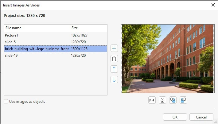

6. Insert New Slides from Images
You also can add new slides to your current project from images. While some of the above methods only allow you to add one new slide each time, this lets you add a series of images as new slides. To do that, open the Home/Insert tab > New Slide > Others section > Slides from Images… After that, the Insert Images As Slides dialog appears.
  • Import images by clicking Slide from Images… button . After that, the inserted images appear on the left, and a selected image is previewed on the right.
  • Click the Remove selected image button to remove unwanted images.
  • Change the image order by moving it up or down. The image order indicates the order of will-be-added slides.
  • Flip or rotate the image if necessary.
  • Select the Use images as objects checkbox to insert images as objects to the corresponding slides. Otherwise, ActivePresenter will import them as the slide background.
Then, click OK to have it done.
Note: If the size of the imported image is larger than the slide size, ActivePresenter 10 will clip it automatically. Therefore, let’s check the image’s size before importing them. Nevertheless, you can change the project size after importing.

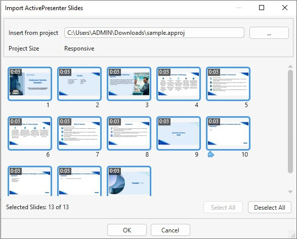

8. Insert New Slides from ActivePresenter Projects
This option allows you to insert slides from other ActivePresenter projects into the current one. Click the arrow on the New Slide button in the Home/Insert tab > Others section > Slides from ActivePresenter… > select a project from your computer > Open. After that, the Imported ActivePresenter Slides dialog appears. Select the slides you want to import and click OK.
Note that you also can copy slides across projects in ActivePresenter 10. Open those projects simultaneously and use copy and paste commands to do that. However, pay attention to the projects’ size before copying. If they are equal in size, object placement will remain unchanged. Otherwise, the copied slides may be clipped.
