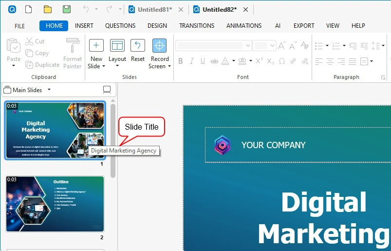

  • The Slides pane when you hover your mouse over each slide.

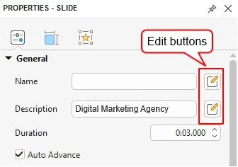

Step 1: Select a slide in the Slides pane.
Step 2: Navigate to the Properties pane > Slide Properties > General. Enter a slide name in the Name box.
Simply type your notes or comments in the Description box for that slide if you would like to add more descriptive information.

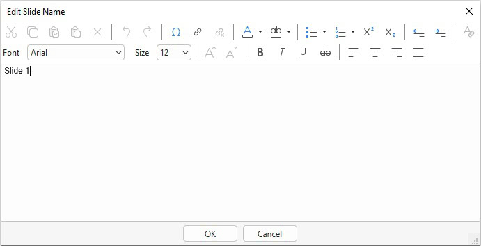

Click the Edit buttons next to the text boxes to further format the slide name or description. A text editor will appear:
As can be seen, this editor has many options for styling slide names and descriptions. Don’t forget this feature in case you want to change the formats.

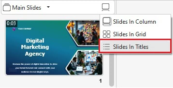

To add slide titles from the Slides pane, firstly, you need to change the slide view mode. Follow these steps to archive that:
Step 1: Click the View Mode icon at the top of the Slides pane, then select Slides in Titles.

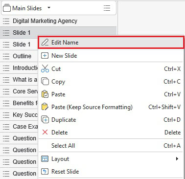

Step 2: Double-click each entry to edit the slide title. Or, right-click an entry > Edit Name to name a slide.
Note: ActivePresenter 10 allows you to name many slides with the same name. Just select multiple slides that you want to give the same name and perform the above steps.

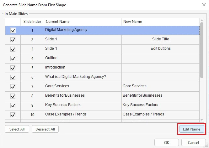

Another way to name slides is by using a batch operation that generates slide names from the first shape in each slide. This is useful when you want to name slides in an interactive simulation. Do the following:
Step 1: Click the ActivePresenter button > Project > Batch Operations > Generate Slide Name From First Shape.
This dialog includes:
  • The Slide Index represents the slide numbers.
  • The Current Name displays the current name of each slide.
  • The New Name shows the text inside the first shape of each slide.
Step 2: Double-click a name in the New Name column. Or, select any row, then click Edit Name. Make sure that the corresponding checkbox is ticked if you want to apply the change.
Step 3: Click OK to close the dialog and apply the changes.

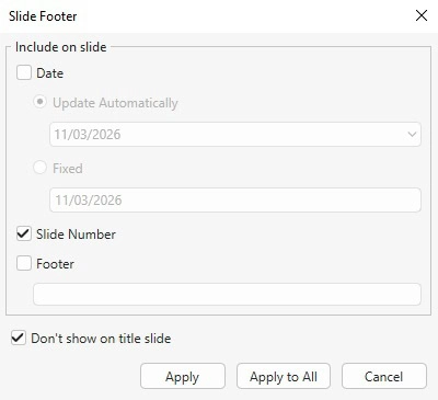

Footer allows you to add dates, slide numbers, and text to the bottom of a slide. To insert a footer, do the following steps:
Step 2: Open the Insert tab > Footer. The Slide Footer dialog pops up.
Step 3: Select the Slide Number checkbox. If you don’t want to show the slide number in the title slide, select Don’t show on title slide.

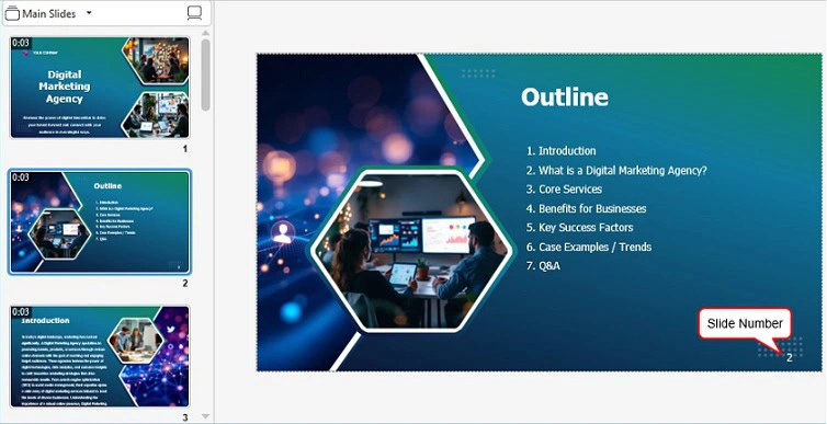

Step 4: Click Apply to insert a number to the selected slide. Or, click Apply to All to add numbers to all slides in the current project.
This number is also the one you see at the bottom-right of the slide in the Slides pane.

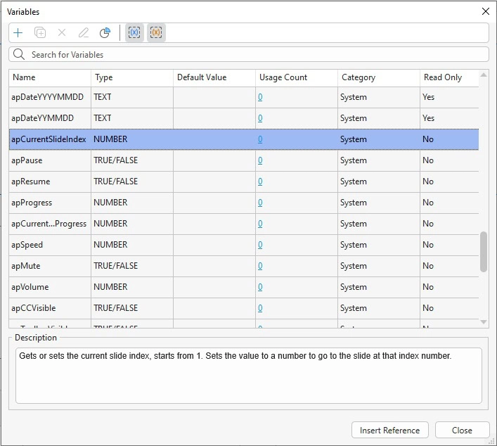

Another way to add slide numbers is using Variables. The system variable “appCurrentSlideIndex” can help to show the current slide number. Follow the steps below:
Step 1: Open the Insert tab > Text Caption or Shape. Insert one of them into the first slide where you want to add the number.
Step 2: Navigate to the Home tab > Variables > select apCurrentSlideIndex.
Step 3: Click Insert Reference to close the dialog and apply the variable to the slide.
