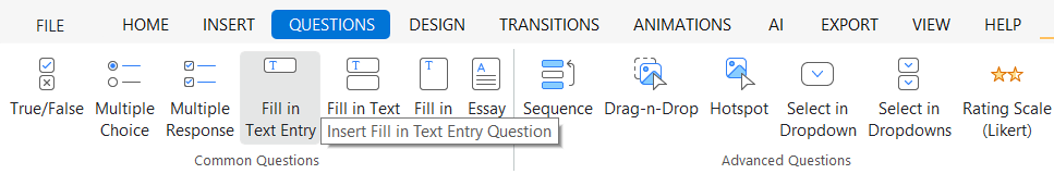

To insert a Fill in Text Entry question, do either of the following:
  • Open the Questions tab > Fill in Text Entry .
  • Open the Home tab > Interactions > Fill in Text Entry .

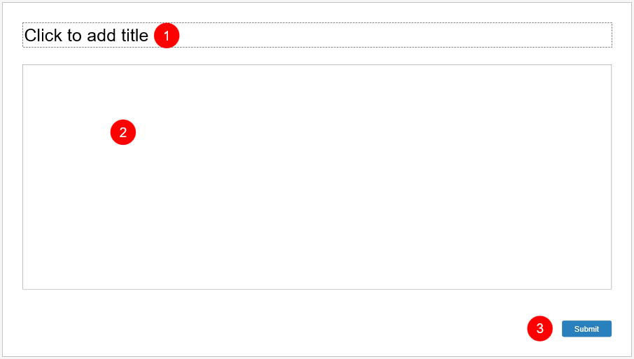

Then, a new question slide appears as the below image:
Fill in text entry question slide
As you can see, a Fill in Text Entry question slide has three parts:
  • (1) the top text box to add a question or a statement providing missing information;
  • (2) the answer area with only one text entry (or the blank) which learners can type their answer in.
  • (3) and the Submit button.

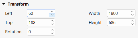

  • Resize the question title (1) and answer area (2): Select them and drag their resizing handles. Alternatively, adjust the Width and Height values in the Properties pane > Size & Properties > Transform to change their size.

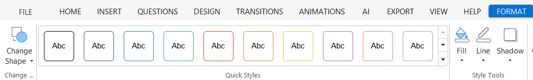

  • Format the text entry: Select the text entry and access the Format tab to change its style the way you want. You can select a built-in style in the Quick Styles gallery. Alternatively, edit it using tools in the Style Tools section or Style & Effects tab of the Properties pane.
Format text entry
  • Change the shape of the text entry: Click Change Shape to change to a rounded-corner rectangle if you want.
  • Reset to the original style: After formatting the text entry, right-click it and select Reset Placeholder if you want to remove all changes you’ve made and reset it to the original style.

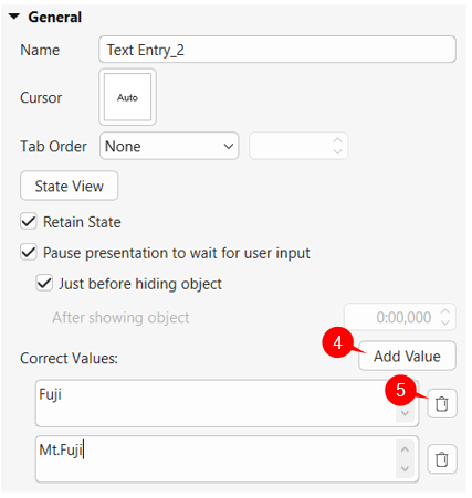

To set correct answers for this question, please follow these steps:
Step 1: Select the text entry, then navigate to the Properties pane > Interactivity > General.
Add correct values
Step 2: Click the Add Value button (4) to display a blank box, then type the correct value into it. Repeat this step until you add enough correct values.
To delete any correct values, click the Remove button (5).

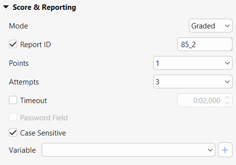

To set the score and reporting for the question, select the answer area, and then navigate to the Properties pane > Interactivity > Score & Reporting
Set score and reporting
This section provides you with a lot of useful options to customize:
  • Mode: Select the Graded mode if you want to measure learners’ performance. Otherwise,  select the Survey mode if you want to collect learners’ feedback or information.
  • Report ID: Track learners’ activities. You can change it to a meaningful ID for easier tracking.
  • Points: Set scores for correct answers.
  • Attempts: Set the maximum attempts that learners can interact with the question.
  • Timeout: Set a time limit that only allows learners to respond to the question in the given amount of time.
  • Password Field: Select this checkbox, all characters that learners type in the text entry will not be shown.
  • Case Sensitive: Select this checkbox to differentiate uppercase and lowercase characters.
  • Submit: Provide two options: Press Key or Auto to submit the entered text.
  • Variable: Define the variable to take place.

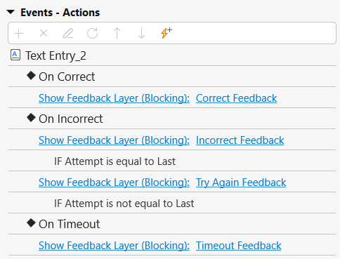

ActivePresenter 10 offers default events and actions for Fill in Text Entry questions. Generally, this question type has four default events for the Graded mode (On Correct, On Incorrect, On Incomplete, and On Timeout) and three for the Survey mode (On Complete, On Incomplete, and On Timeout).
If you’ve selected the Graded mode, here is what you’ll see:
Add events-actions
You can remove, change, or make events and actions more advanced as you wish. To do that, first, select the answer area. Then, access the Properties pane > Interactivity > Events – Actions
