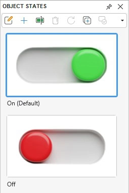

A toggle button consists of two states, on and off. You prepare an image as the ‘on’ state then access the View tab > Object States to add the other ‘off’ state to it.
two states of the toggle button

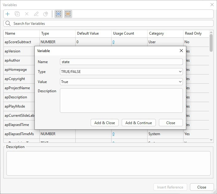

If you click on the toggle button, the two states will show up in turn. For that to happen, you need to use a true/false variable and change its value to true or false for each state whenever the toggle button is clicked.
To create a true/false variable, you navigate to the Home tab, then click on Variables.
Insert variable from the Home tab
In the dialog that appears, click on the blue plus button at the top to add a new variable, select the TRUE/FALSE type, and define its initial value if any. Then, click Add & Close to finish.
create a true false variable

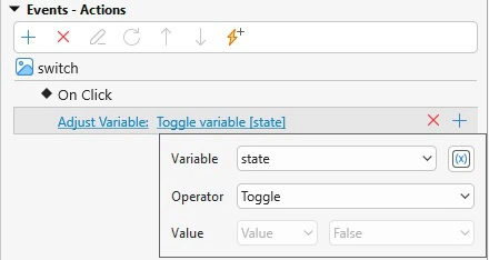

Firstly, you select the button and navigate to its Properties pane > Interactivity > Events – Actions. Then add the On Click event and the Adjust Variable action. To enable the toggle function, you select the true/false variable created earlier from the list and the Toggle operator.

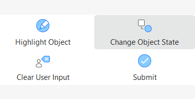

After that, you add the Change Object State actions and conditions corresponding to each state as follows:
change object state action using true false variable as conditions
Since the initial value of the variable is True, so you should assign it to the default ‘on’ state. And assign the ‘false’ value to the other state.
