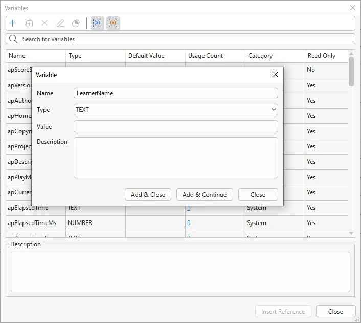

Text variables hold text-based values. So you can use them to store information such as names, passwords, and years. To create a text variable, you access the HOME tab, then click on Variables.
variables
In the dialog that pops up, click on the blue plus icon in the top toolbar to add a new variable, then select the TEXT type, and define its initial value if any.
create text variable
Click Add & Close to finish.
