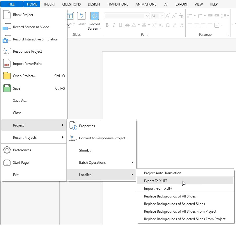

To export text in your project to XLIFF format, take the following steps:
Step 1: Click on the FILE button, select Project > Localize > Export to XLIFF.
export to XLIFF for project localization

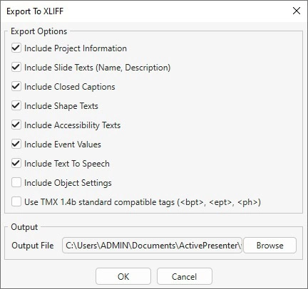

This opens the Export to XLIFF dialog as below.
export to XLIFF dialog
Step 2: Select the types of text that you want to export for the translation in the Export Options section.
Select Use TMX 1.4b standard compatible tags (<bpt>, <ept>, <ph>) if your translation tool doesn’t support <g> and <x/> tags.
Step 3: Enter the output location and file name in the Output File box and then click OK to start exporting to XLIFF.

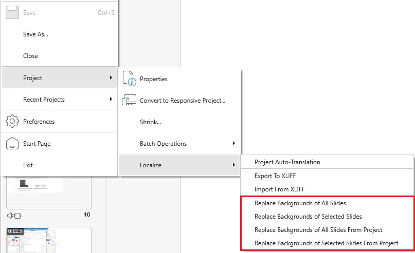

In case you need the copied project to have the backgrounds different from the original project then you can use the Slide Background Replacer. You can do as follows:
Step 1: Open the copied project. Then click on the FILE button > Project > Localize.
replace background
  • Replace Backgrounds of All Slides: Replace all slides’ backgrounds with slides from another project. Selecting this option will launch the blue rectangle and the Replace Slide Backgrounds dialog. After that, start to capture a new project as normal. Note that only mouse click and key press actions create slides with background. If you take drag-and-drop and mouse scroll actions, the captured project will have a video slide with no background. See Record Screen as Videos and Record Interactive Simulations for more details.
  • Replace Backgrounds of Selected Slides: Replace some selected slide backgrounds with slides from another project. Selecting this option will also launch the blue rectangle and the Replace Slide Backgrounds dialog. Then, you can capture a new project as normal.
  • Replace Backgrounds of All Slides From Project: Browse another project to replace all slide backgrounds of the current project.
  • Replace Backgrounds of Selected Slides From Project: Browse another project to replace some selected slide backgrounds of the current project.
