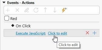

So, to add custom scripts with the Execute JavaScript action, do as follows:
1. Select one of the colored buttons.
2. Navigate to its Properties pane > Interactivity tab > Events – Actions section > Add the On Click event.
3. Assign the Execute JavaScript action to the On Click event. Then, click Click to edit. A dialog appears allowing you to write a script.
add code
Write the script like the below image.
write code

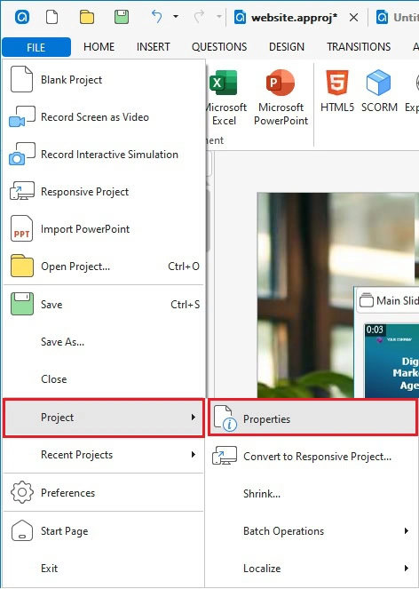

Besides running custom JavaScript actions in the object or slide’s events, you can execute JavaScript when the project loads. Perform the following:
Step 1: Click the FILE button > Project > Properties.

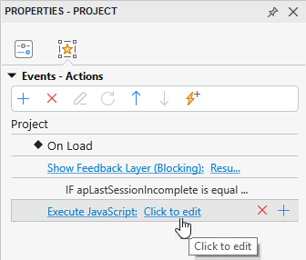

Step 2: Navigate to the Properties pane > Interactivity tab > Events – Actions section > add the Execute JavaScript action to the On Load event of the project.

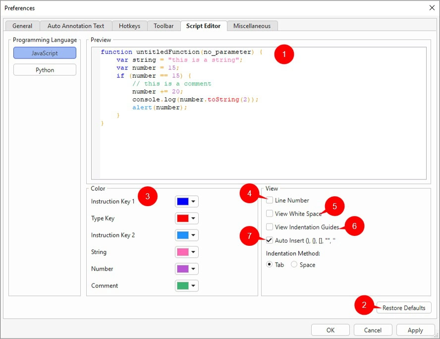

To customize the appearance and behavior of the Script Editor in ActivePresenter 10, open the Preferences dialog and switch to the Script Editor tab. Any changes you make are immediately reflected in the preview editor (1).
You can also choose a programming language for scripting, including JavaScript and Python, in the Programming Language section.
If needed, click the Restore Defaults button (2) to return to the original settings.
Script Editor
Change Editor Colors
In the Color section (3), you can customize the colors of different code elements such as instruction keys, strings, numbers, and comments. Click the color box next to each item and select a color from the color picker.
Change Code View Options
In the View section, select the checkboxes to adjust how code is displayed:
  • Show line numbers (4)
  • Show white space characters (5)
  • Show indentation guides (6)
  • Automatically insert matching brackets and quotes (7)
You can also choose the indentation method by selecting either Tab or Space, depending on your coding preference.
