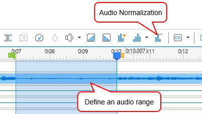

Step 1: Select the entire track, or multiple tracks, or define an audio range that you want to normalize.
define an audio range to normalize it
Step 2: Click the Audio Normalization button Audio Noralization icon in the Timeline pane. Then, the Audio Normalization dialog will appear as the image below. Adjust the settings or keep the default settings and click OK to normalize the selected track.
