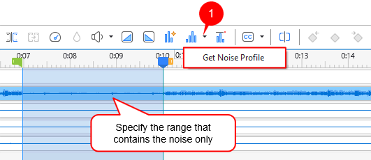

ActivePresenter 10 lets you reduce background noise for the whole audio track or just a part of it. To do that, firstly, you need to get a noise profile. A noise profile is an audio sample that contains the noise only. Now, let’s perform these steps:
  1. Select the entire track or drag the Start and End markers of the Playhead to specify the range that contains only background noise.
  2. Click the drop-down arrow next to the Audio Noise Reduction button (1), then select Get Noise Profile.
Get noise profile to reduce background noise
  • When getting a noise profile, you shouldn’t choose a very short range because the app cannot get the noise profile. A selection of 2 – 4 seconds of only noise is recommended.
  • The noise profile you got will be stored in the application. It will be lost in case you close the program or replace it with another noise profile.

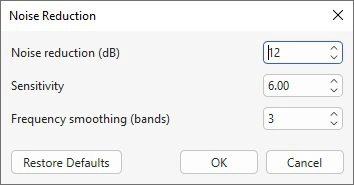

  2. In the Timeline pane, click the Audio Noise Reduction button. Then, the Noise Reduction dialog will appear to let you customize:
set up noise reduction dialog to reduce background noise
Noise reduction (dB)Control the amount of volume reduction (0 – 48 dB) applied to the identified noise. Higher values reduce higher amounts of volume reduction, making the noise quieter but can distort the audio track. So, keep this control as low as possible.
SensitivityControl how much of the audio will be considered as noise. Greater sensitivity will remove more noise but it can damage the track. Thus keep this control as low as possible.
Frequency smoothing (bands)Spread the noise reduction into the specified number of neighboring bands. Smoothing can make the desired audio less clear, so set the value to 0 if your desired signal is strong and the noise is low.
  1. Click OK to apply the effect to the selected ranges.

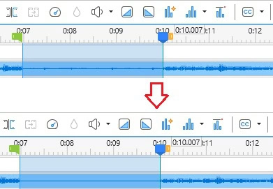

Then you will see the change in the waveform of that noise in the Timeline pane. That means noise has been reduced to a certain level.
change in waveform

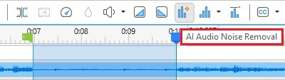

  1. Select the audio track or the part of the audio that contains noise.
  2. On the Timeline pane, click AI Noise Removal.
  3. ActivePresenter will automatically analyze and clean the audio.
The AI model identifies unwanted background sounds and removes them while keeping the speaker’s voice clear and natural.
