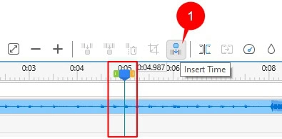

Step 1: Select one or more audio/video objects. Hold CTRL while clicking to select multiple of them.
Step 2: Seek the Playhead along the timeline to the position where you want to pause the track.
Insert time
Step 3: In the Timeline pane > click the Insert Time button (1). This opens the Insert Time dialog.
insert time dialog
You specify the duration of the silence you want to add to the track, then click OK

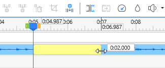

After that, Active Presenter will add silence to the selected track(s) at the Playhead position. The silence added is represented as the yellow bar.
insert silence
Customize the Added Silence
In general, the length of the yellow bar is adjusted to the duration you have defined in Step 3 above. However, you can customize the start time and duration of the inserted time as you want:
  • Drag the whole bar along the timeline to change the start time.
  • Drag the right-side edge of the yellow bar to the right or left to increase or decrease the duration of the added time respectively.
change duration of the silence

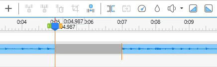

To remove added silence from the host track, you drag the yellow bar downward until it turns gray and release the mouse button.
delete the added silence
As a result, the added time will disappear and the duration of the host track will be reduced. Obviously, the video/audio track will go back to its original properties.
