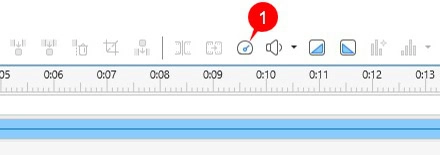

Step 2: Click the Change Playback Speed button (1).
change playback speed feature in timeline pane

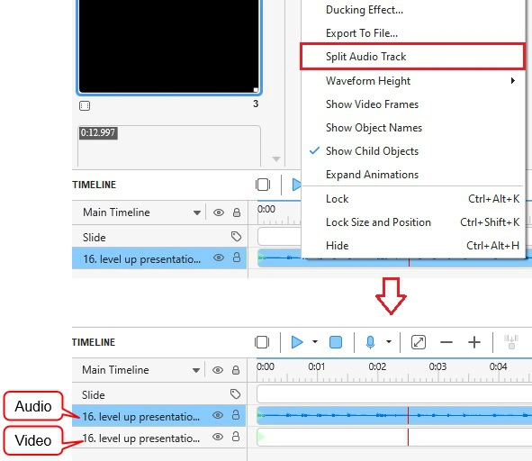

Tip: The best practice of this Change Playback Speed feature is to apply it to video objects not containing audio. That’s because when you change the speed of the video containing audio, the playback speed of both will be affected as well. If you need to speed up or slow down video only, ActivePresenter 10 now helps you separate audio from the original video in a flash. To do that, you right-click on the video and select Split Audio Track. Then, ActivePresenter will automatically separate your video into 2 different video and audio objects in the Timeline pane. Now you can change the playback speed of the video object as normal.
separate audio from video

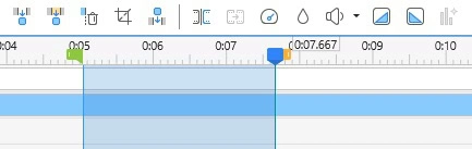

Step 1: Drag the Start marker (green) and the End marker (yellow) to define the range of the video you want to speed up or slow down.
define range to change speed

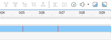

Step 2: Click the Change Playback Speed button (1) and enter the value in the dialog as mentioned above. In the Timeline pane, the red marks show where the video is sped up or slowed down.

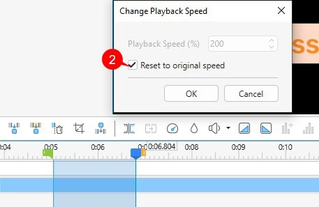

After making changes, you still can restore the original speed. To get it done, do as follows:
1. Select the whole video or drag markers of the Playhead to select exactly the range that you have changed the speed before (the range between two red marks).
2. Click the Change Playback Speed button (1).
3. Select Reset to original speed check box (2).  Finally, click OK.
reset video to original speed
