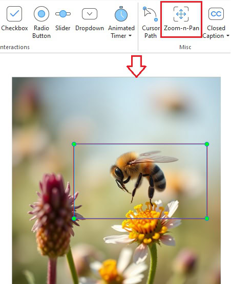

Step 1: Insert a zoom-n-pan object by clicking Zoom-n-Pan in the Insert tab.
Then, you will see the zoom-n-pan rectangle appear on the Canvas with four green handles.
insert a zoom-n-pan object to the Canvas

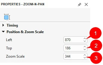

Step 2: Change the zoom effect position by doing either of the following:
  • Hover the mouse over the outline of the zoom rectangle and drag it to the position you want.
  • Open the Properties pane > Size & Properties tab > Position & Zoom Scale section, change the values in the Left (1) and Top spin box (2). This way provides more precise positions of the zoom effect on the slide, in which:
    • Left: X position of the zoom rectangle from the left side.
    • Top: Y position of the zoom rectangle from the top side.
change position and zoom scale
Step 3: Change the zoom scale. You can do that by performing one of the following:
  • Hover the mouse over one of the four green handles until the mouse turns into a double-headed arrow, then drag the handle.
  • Enter a value in the Zoom Scale spin box (3) (Properties pane > Size & Properties tab > Position & Zoom Scale section). This way provides a more precise zoom scale.

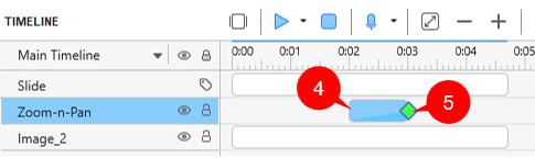

Step 4: Change the zoom effect start time.
The zoom effect will start to zoom in at the starting point of the object (4) and end at the green diamond (5). The light blue area inside the object Time Bar indicates the effect timing.
change zoom effect start time

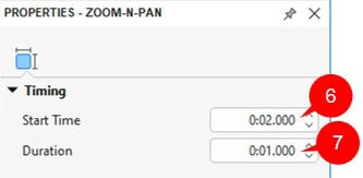

To change the start time of the zoom effect, do one of the following:
  • Select the zoom effect object time bar on the Timeline pane > the mouse turns to a four-way arrow > drag it to the left or right. Besides, you can drag the starting point (4) to change the effect start time. However, using this way will change the effect duration at the same time.
  • Access the Timing section of the Properties pane, and enter a value in the Start Time spin box (6).
Timing section of zoom-n-pan
Step 5: Change the zoom effect duration.
By default, the duration of the zoom-n-pan effect is one second. But you can change it to any other value you want. Make sure the effect duration shouldn’t too short or too long as it might cause the zoom in and out to appear in a hurry or disjoint. Two or three seconds are good to go with since a smooth effect is better for viewers to follow.
To adjust the length of a zoom effect, do one of the following ways:
  • Drag the green diamond (5) to the left or right to decrease or increase the duration, respectively.
  • Enter a value in the Duration spin box (7) in the Timing section of the Properties pane.
