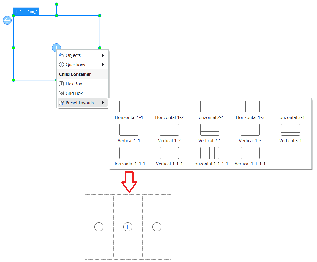

To insert a flex box, you click on the Home or Insert tab > Container > Flex Box.
insert flex box
After that, a flex box will appear on the Canvas. You can click on the green plus button in the center to add any types of objects or questions you want.
flex box on canvas
A flex box can contain one or more other flex boxes. Select Preset Layouts to insert one of the pre-made flex layouts.
preset flex layouts

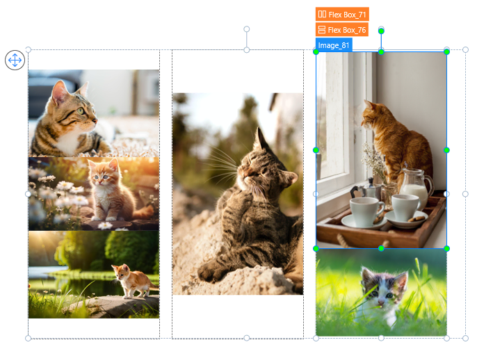

When you add an object to a flex box, the object is called a flex item or flex child. For example, the flex box above contains three small flex boxes. You can click on the plus icon in the center of each box to insert other items.
insert object

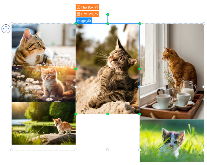

Tip: There may be several flex items overlapping others. Then you can click on the label at the top to make sure you select the right item.
As the flex box uses the flex layout, a flex item can adjust itself to fit the container. You cannot change size and position of a flex item manually on the Canvas. Instead, you can do that through the flex container layout and the flex child properties.

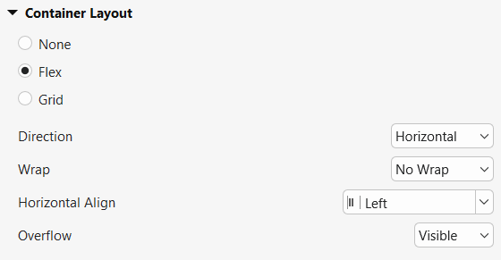

Adjust Flex Container Layout
The flex container layout contains the properties of the whole Flex Box (Flex Box_71). You access the Flex Box’s Properties pane > Size & Properties > Container Layout
flex container layout properties
DirectionFlex layout will keep objects displaying along a row (in the horizontal direction) or a column (in the vertical direction). Select the direction (either Horizontal or Vertical) that you want to align objects.
WrapSelect No Wrap or Wrap to specify whether objects should be in one line or wrapped onto multiple lines.
Note that the wrapping behavior only happens when items in a flex box are too large to display all in one line. In this case, when you select Wrap, they will be wrapped onto another line.
Vertical/ Horizontal AlignAlign items vertically or horizontally.
Align Columns/ Align RowsWhen the Wrap option is selected, flex box allows breaking objects into multiple lines. Use the commands to align those lines.
OverflowDetermine how the content in a flex container is displayed if it overflows the container and whether a scroll bar should appear or not.
Visible: The overflow isn’t clipped and it renders outside the container.
Hidden: The overflow is clipped; any content that extends beyond the container will be hidden.
Auto: If the overflow is clipped, a scroll bar will appear and help you view the rest of the content.
Note that you can only scroll the scroll bar from left to right and from top to bottom in the flex box. Therefore, all items that overflow the left and/or top position of the flex box couldn’t be shown.

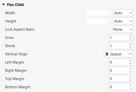

Change Flex Child Properties
As the three small flex boxes are inside the flex container, they are also the flex children of the flex container. You can see their properties in the Properties pane > Size & Properties > Flex Child
See the explanation below:
Width/HeightDefine the base width/height of a flex child by percentage, pixel or auto. Auto means the base width/height is based on the object content. The content can be either text if the object is a shape or the total base width/height of children if the object is a nested flex box.
Lock Aspect RatioDefine the base width/height of a flex child by percentage, pixel, or auto. Auto means the base width/height is based on the object content. The content can be either text if the object is a shape or the total base width/height of children if the object is a nested flex box.
GrowSpecify how the free space of flex box is distributed to its children in the value range from 0 – 100. If the value is equal to 0, a flex child keeps its base size. Otherwise, depending on the Direction set in its flex container, a flex child will grow in width or height to occupy the free space in the flex container.
ShrinkShrink objects that have a greater total base size than the container size to fit the container. Specify the value from 0 – 100. If the value is equal to 0, a flex child keeps its base size. Otherwise, depending on the Direction set in its flex container, a flex child will be shrunk in width or height to fit the container.
Horizontal/Vertical AlignAppear if the Direction in a flex container is set to Vertical/Horizontal. Then, select one of four options in the list to align a flex child horizontally/ vertically.
Left/Right/Top/Bottom MarginSelect Width or Height to maintain the aspect ratio of a flex child according to its width or height respectively. If you select None, you can freely resize both the width and the height.

  • Select the first flex box, change the Width and Height to %, Width to 30%, Grow to 0, Right Margin to 15. Do the same for the second and the third flex boxes but you don’t need to set the right margin to the third one.
change properties for small flex boxes
  • Select each image in the first flex box, in the Flex Child section in the Properties pane. Change the Lock Aspect Ratio to None, Bottom Margin to 15. Note that the third image doesn’t need the margin setting.
  • Select the image in the second flex box, change the Lock Aspect Ratio to None, Width to 100% and Height to 70%.
  • Select the first image in the third flex box, change the Lock Aspect Ratio to None, Height to 80%, Bottom Margin to 15. Also, change the Lock Aspect Ratio of the second image to None

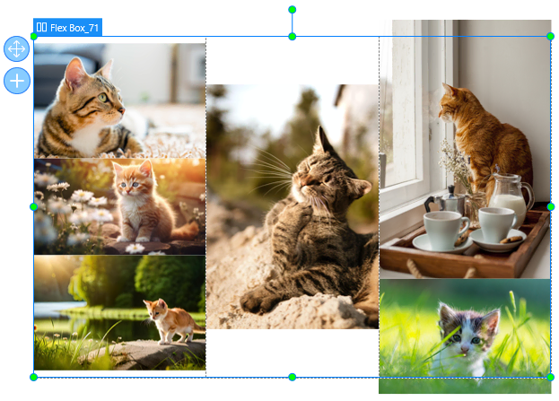

And here is what we got:
flex layout
