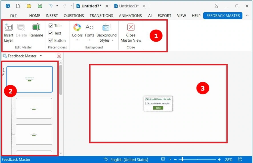

In general, this view includes three main parts:
  1. The Feedback Master tab’s toolbar contains groups of useful commands for you to work with.
  2. The left pane consists of a Master Feedback Layout and feedback layers.
  3. The Canvas previews changes of the selected layer in the left pane.
By default, a feedback master includes 1 Master Feedback Layout and 9 built-in feedback layers. The Master Feedback Layout is the base layer that other feedback layers inherited from its look. See the image below for details:
master feedback layout and feedback layers

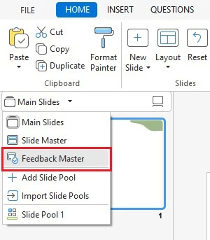

Step 1: Open the master view by accessing the Slides pane > Feedback Master. The master view shows up with the Master Feedback Layout selected.
Feedback Master on the Slides pane

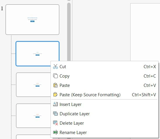

You can make changes to the Master Feedback Layout to apply alterations to all of its feedback layers. Or, directly click on the feedback layer that you want to style it. Then, perform any of the following:
  • Right-click it > Cut/Copy/Paste or Insert/Duplicate/Delete/Rename Layer/Master or Preserve Master. Some commands can be done using the toolbar.
  • Define which placeholders will be included in the selected layers (title, text, button) using the toolbar’s available options.
  • Change its background style (Properties pane > Slide Properties > Background Fill).
  • Customize the layout to add images, shapes, etc. (Insert tab) or modify the default feedback message.
Step 3: Click Close Master View to save all the changes and go back to the normal editing view.

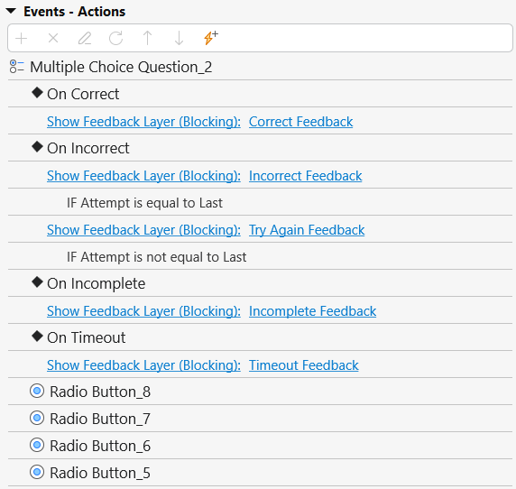

Step 4: Assign feedback layers.
ActivePresenter 10 displays feedback layers to provide feedback for each question’s answer. See the image for details:
As can be seen, each question event shows a corresponding feedback layer. For example, when learners answer a question correctly, a correct feedback layer appears. Click on the feedback layer name then ActivePresenter 10 offers you other three options to further set up your questions.
Correct feedback
  • Variable: Check this option to use the variable to show a specific feedback layer.
  • Hide After: Allows hiding the feedback layer automatically after a period of time.
  • Blocking: Allows blocking the main timeline when the feedback layer is showing.
