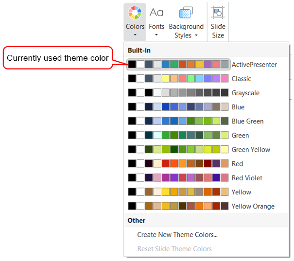

To access the theme colors gallery, open the Design tab > Colors. Take a look at the image below for details:
Design tab > Color > select a theme color.
As you can see, the gallery includes three sections:
  • Custom: Contain the theme colors you’ve created.
  • Built-in: Contain ready-made theme colors.
  • Other: Allow you to create or reset theme colors. See the next part of this post for information.
The currently applied theme color is highlighted with a gray outline. Basically, a theme color is a set of different colors in which the first four colors (from left to right) represent text and background colors (light and dark for each). Meanwhile, the rest illustrates six accent colors for objects such as shapes and images.
Note: You can hover the mouse over any theme color in the gallery to preview how they change the look of your slide.

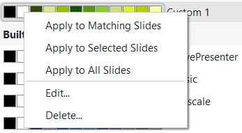

To have more options, right-click a theme color and select one of the following:
Apply a theme color
  • Apply to Matching Slides: Apply to all slides that use the same slide master as the current slide. It works as you left-click to select a theme color.
  • Apply to Selected Slides: Apply to the selected slides only. If the new theme color doesn’t please you, click Reset Slide Theme Colors to discard the change.
  • Apply to All Slides: Apply to all slides in your working project.
  • Edit…: Modify the selected theme color. This option is available for custom theme colors only.
  • Delete…: Remove the selected theme color. After that, it will disappear from the theme colors gallery. This option is available for custom theme colors only.

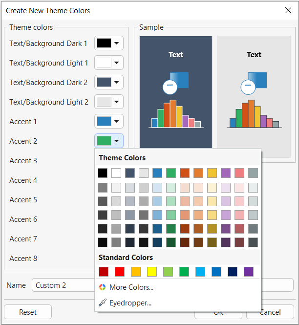

Step 2: Select Create New Theme Colors… Then, the Create New Theme Colors dialog appears like the image below:
Create new theme colors
The dialog has two main sections:
  • Theme colors: Consist of 12 current theme colors. Each includes 4 text/background colors and 8 accent ones. Click the color dropdown lists to set the colors you want.
  • Sample: Preview the changes you make in both dark and light UI.
These color choices also determine preset colors available when you select fill and outline colors for objects. So, be careful!
Tip: When specifying colors, especially accent ones, it’s better to look at the Sample box. This box gives you a preview of changes. So, you know how a color looks next to another in a column or bar chart.

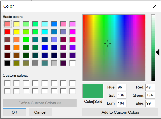

As mentioned above, each theme color includes 4 text/background colors and 8 accent ones. Once you have already created a custom theme color, the Color Picker will have new tints and shades automatically created by ActivePresenter 10. It’s impossible to control how tints and shades are defined. But you can adjust them by clicking More Colors. Note that shades and tints can be slightly different, depending on the used theme color.
Select colors.
Besides, the order of 12 colors is crucial. The order of text and background colors defines which color will be used as the default text color and default background. Dark 1 and Dark 2 should always be dark colors. Likewise, Light 1 and Light 2 should always be light colors. With these in mind, keep black and white among the first four text and background colors.
