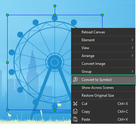

You create animation symbols by converting one or multiple elements on the Canvas. Do the following steps to convert animations to symbols:
- First, select one or multiple elements of the same parent.
- Next, right-click the selected elements > Convert to Symbol.
- Then, in the Convert to Symbol dialog, type a unique name for the new symbol.
- The Create Playback check box is selected by default to create playback animation for the new symbol. If you don’t want to create a symbol playback at this time, clear the check box. Later, use actions to control symbol playback.
- The Fit to content check box selected by default helps to fit the symbol element to the content, according to its size and position. If you deselect this box, the symbol element will take up its scene’s size. In this case, the size of the symbol element is relative to the scene size and starts at 100% of the scene size. When changing the size of the symbol element in the main document, the size of the symbol in editing mode also changed. If you want the size of the symbol element to be absolute, change the size unit to pixels (px). In a responsive project, if we add a symbol element (which hasn’t been inherited from the base layout) into a responsive layout, this option will be disabled.
- Click OK to convert the selected elements into a symbol. Saola Animate adds the new symbol to the Resources pane. The selection on the Canvas becomes a symbol element of that symbol.

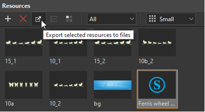

Export Symbols
The Resources pane manages all resources of a document, including symbols. From here you can export a symbol as a single file (*.saolasym). Do the following:
- In the Resources pane, select a symbol resource you want to export.
- Click Export selected resources to files in the toolbar or right-click the symbol > Export.
- Provide a file name for the exported symbol and click Save to export.
