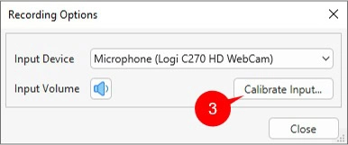

Calibrate Audio Input When Recording Narration Only
To calibrate audio input when recording narration, do the following:
Step 1: Click the drop-down arrow on the Record Narration button (1) in the Timeline pane and select Recording Options (2).
Step 2: In the Recording Options dialog that pops up, click Calibrate Input… (3).
The Calibrate Audio Input dialog which is the same as the one mentioned above will pop up.

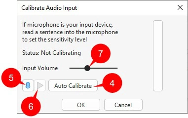

Calibrate Audio Input Automatically
First, take a look at the dialog below. It pops up when you click the Calibrate Audio Input…in the Settings or Calibrate Input… (3) above.
Now, take the following:
Step 1: Click the Auto Calibrate button (4). The Auto Calibrate button will turn into Stop Calibration.
Step 2: Speak something in your normal volume into the microphone. Keep speaking so that Active Presenter can automatically optimize the gain.
After a few seconds, the button changes from Stop Calibration to Auto Calibrate again, which means the calibration is over.
Remember that you should try to speak louder or smaller during the testing time for a better result.
Calibrate Audio Input Manually
To calibrate the microphone manually in Active Presenter 10, do the following:
Step 1: Keep the microphone in its normal position. Click the Record Narration button (5). This button will turn into the Stop button.
Step 2: Speak something into the microphone.
At the same time, move the slider (7) to the right until the LED bar on the right shows yellow bars intermittently.
If the bar starts showing red LEDs, move the slider a bit to the left.
Step 3: Click the Stop button to end the calibration when you are satisfied with the audio level.
Step 4: Click the Play button (6) to listen to the recorded voice. If the audio level is not good enough or if it has any defect such as breathing noise, repeat steps 1-4.
Regardless of the calibration method, the volume adjustment is accepted only when you click the OK button. If you click the Cancel button, Active Presenter will discard the new value and apply the old one.
