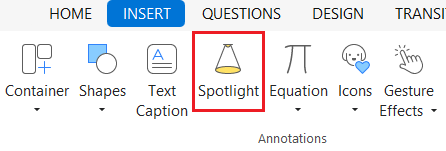

Step 1: Open the Insert tab > Spotlight. Then, the mouse cursor turns into a crosshair.
insert spotlight

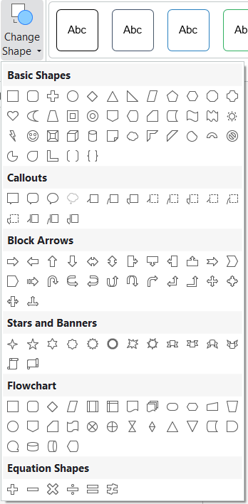

To change the shape of the spotlight effect, select it > navigate to the Format tab > Change Shape > click a shape in the list.
Change spotlight shape
Then, the shape you selected will be applied to the spotlight.

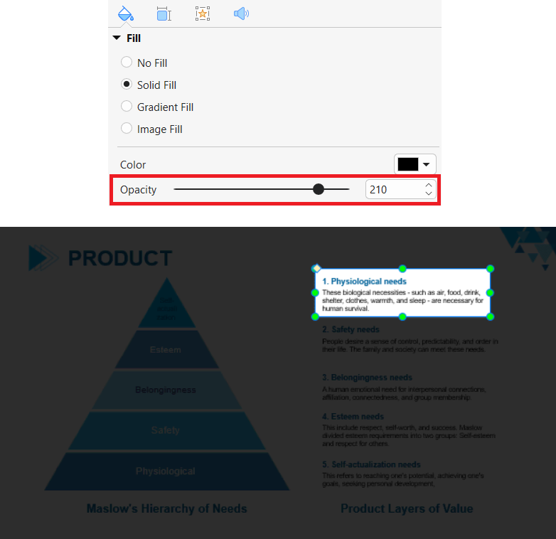

This step is to increase the contrast between the bright and dark areas of the spotlight effects. Therefore, the highlighted object can be seen more obviously. To do that, in the spotlight’s Properties pane > Style & Effects tab > Fill section > change the Color (if needed) > change the value in the Opacity box. Or, drag the opacity slider to archive that.
opacity effect

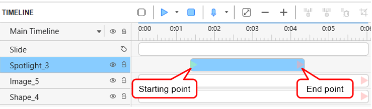

Step 1: Select the spotlight on Canvas. Its timing on the Timeline pane will be highlighted.
Start and ending time of spotlight in timeline pane
Step 2: Change the start time by doing either of the following steps:
  • Drag the object along the Timeline pane to the time stamp you wish.
  • Drag its starting point. However, this way will change the spotlight effect’s duration.
  • Navigate to its Properties pane > Size & Properties tab > Timing section > enter new values to the Start Time box.

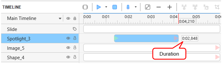

Step 3: Change the spotlight effect’s duration by performing one of the steps below:
  • Drag the spotlight object’s endpoint to the position you desired. The duration will show up while you are dragging.
Change spotlight duration in timeline pane
  • Change the value in the Duration box of the Timing section in its Properties pane.

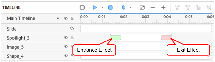

Moreover, you can add the entrance and exit effects to the spotlight effects. To do that, select them and navigate to the Animations tab > select ones in the Entrance and Exit Effects
Tips: When adding another spotlight right after the first one ends, you should add entrance and exit effects to those objects to make a smooth transition between them. Also, the entrance effect of the second spotlight should appear exactly at the time when the exit effect of the previous one starts.
Change entrance and exit effect of spotlight
