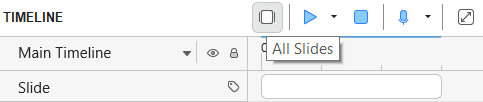

After that, in the Timeline pane, click the All Slides button to view all the slides in the current project as well as the objects that span across multiple slides. Note that the Show over Multiple Slides option depends on the duration of an object.
All slides button
