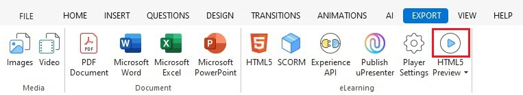

To preview the project, click the HTML5 Preview button in the Home, or Export tab.
Preview the HTML5 Output
By default, when you click the HTML5 Preview button, it will preview the content in the Tutorial mode. But, if you click this button after previewing in a specific mode, it will achieve this preview mode for future use.
Note: If you select the first slide and then click this button, it will preview the whole project. Otherwise, it previews the last selected slide.
Besides, you can select a specific mode to preview the content. Click the dropdown arrow on the HTML5 Preview button, then select one option from the list.
