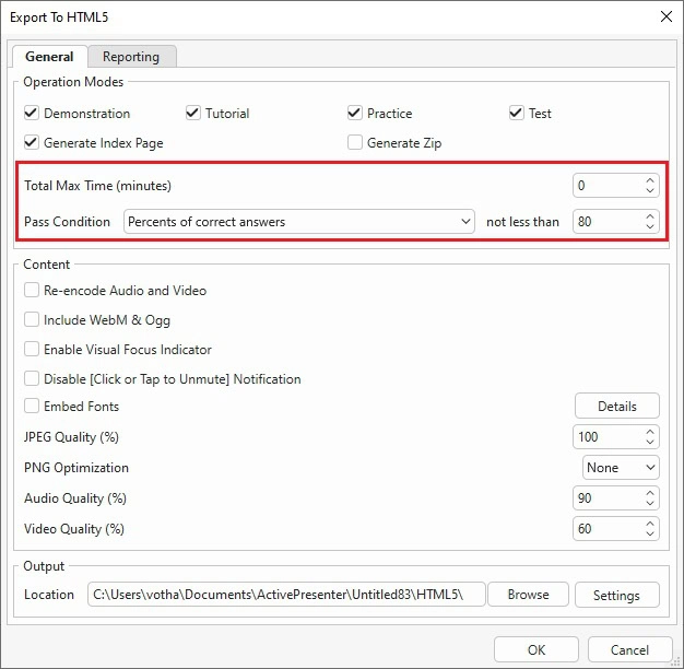

To set a test duration and pass condition, click the Export tab > HTML5. In the Export To HTML5 dialog that appears, focus on the Operation Modes section of the General tab.
Set test duration and pass condition
1. Test Duration
The Total Max Time option is available for the Tutorial, Practice, and Test modes to set a time limit (in minutes) on an entire test. This is the total amount of time required for learners to complete the test.
2. Pass Condition
Pass/Fail conditions determine the status of the test is either passed or failed, which is usually essential for compliance courses or certification activities. When a learner meets the condition, he is marked as passed. Otherwise, he is marked as failed.
To set the pass/fail condition, take the following steps:
1. Choose one condition from the list (1).
Choose a condition for learners to pass a test
2. Type a numerical value that is less than or equal to 100 in the spin box (2).

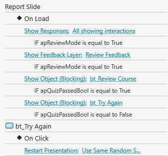

In ActivePresenter 10, the test’s pass/fail condition is represented in a system variable called apQuizPassBool. Its function is to return the result of the quiz as true (passed) or false (failed). You can use this variable as a condition for an action to occur.
For example, at the end of the test, if the learner passes the test, a Review Course button shows up to let them see their results. Otherwise, when the learner fails, a Try Again button appears and allows them to do the test one more time.
Use pass fail condition to take action
Here’s how:
  1. Add a Report Slide at the end of the test. Since there is already a Review Course button, you just need to create the Try Again button (Insert tab > Button).
  2. Add the Restart Presentation action to the On Click event of the Try Again button (select the button > Properties pane > Interactivity tab > Events-Actions section)
  3. Hide these two buttons from the beginning by right-clicking them > Initially Hidden.
  4. Add actions to show two buttons to the On Load event of the Report Slide, using the apQuizPassBool variable like this:
Use apQuizPassedBool variable
