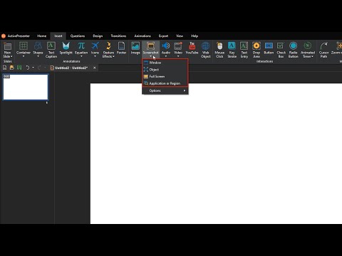

Taking screenshots with ActivePresenter is quite easy. You can capture windows, objects, the full screen (also the desktop), applications, or regions of your screen. Just click the Insert tab > Screenshot > select a mode.
Before capturing, you can adjust some settings by clicking Options.
