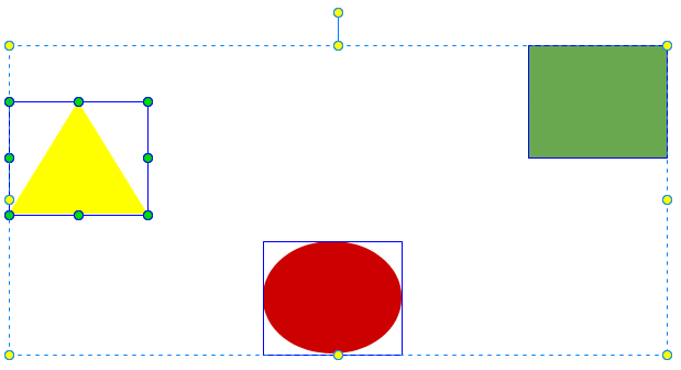

Saola Animate 3 provides users with three sizing options to resize elements. It allows making them the same width, height, or both. To get it done, you can resize elements on the Canvas to the reference element. The reference element is the last selected one and is defined by the green handles, while others have blue boundaries.
Resize and align elements, reference element.
To resize elements, follow the below steps:
Step 1: Select all elements you want to resize and define the reference element.
Note: You can click any selected element without holding down CTRL to define it as the reference.
